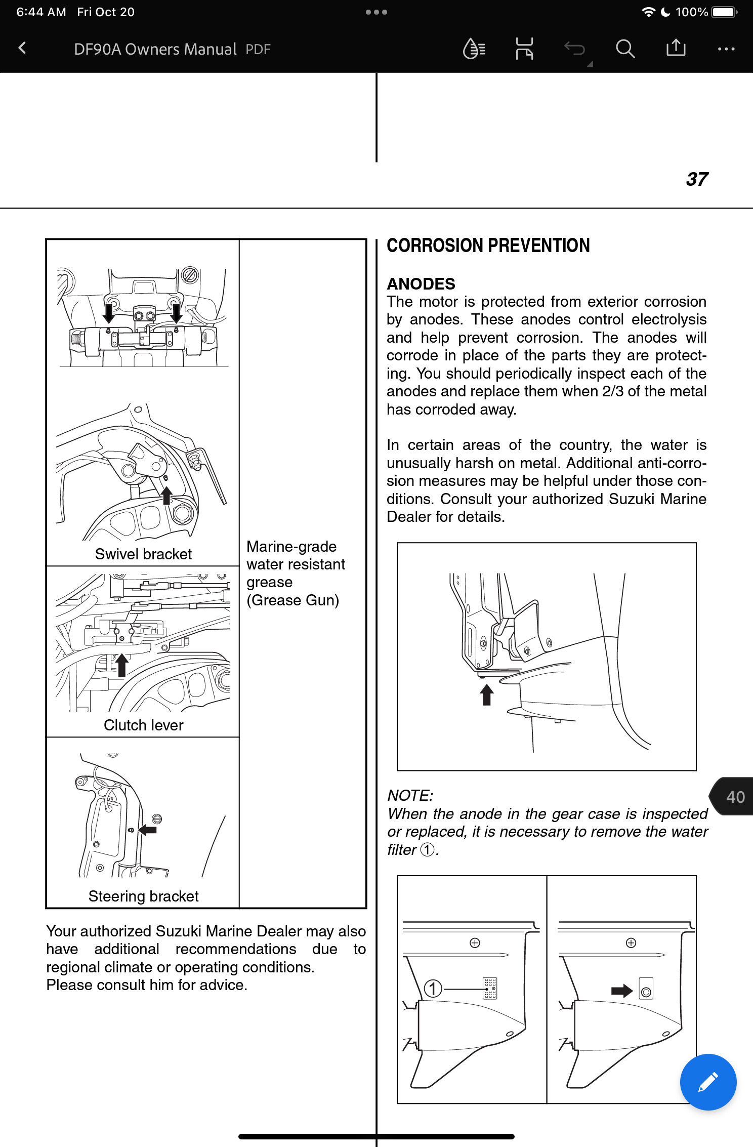

On my 2009 DF90A I have a grease nipple for the shift shaft. I have to take the starboard plastic panel off to access it, I think you can see it with the panel on. Owners manual would have the location
Thank you William. I will remove the starboard panel and look for a grease nipple. As far as the tension screw on the binnacle, there is no obvious adjustment screw externally, likely on the inside of the binnacle.
I think the problems stems from the shift shaft. Either bent or poorly lubricated. I'm really hoping to find a grease nipple. When when I moved the throttle control forward or back engaging the gear it is very sticking. When throttle control moved to increase idle without engaging the gear it seems to move more freely.
It’s the clutch lever grease zirk your looking for. I’m ASSUMING your engine has one but I don’t know for sure.
Point #11. That’s all I have for the easy stuff. If grease won’t fix your hard shifting you will have to dig deeper.
