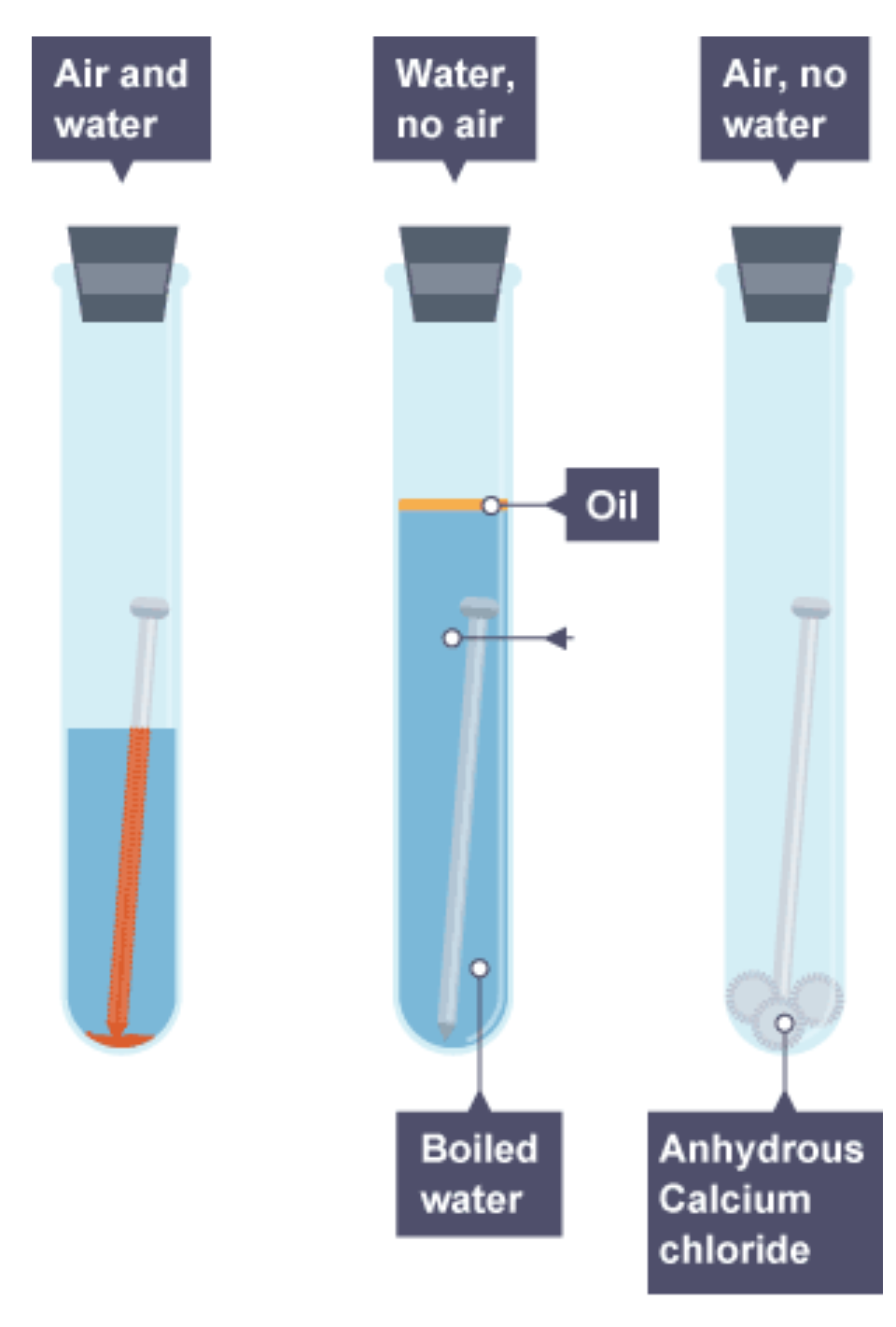

Right. Once exposed to oxygen, the trouble begins. Maybe that's why they call rust "oxidation". See this illustrated here with a steel nail.

It is even worse in a motor with non similar metals.-----A perfect galvanic cell.----I am going to be blunt and say that some folks are not aware and slow to accept the fact that the motor will suffer within hours if water is on the bearings.
