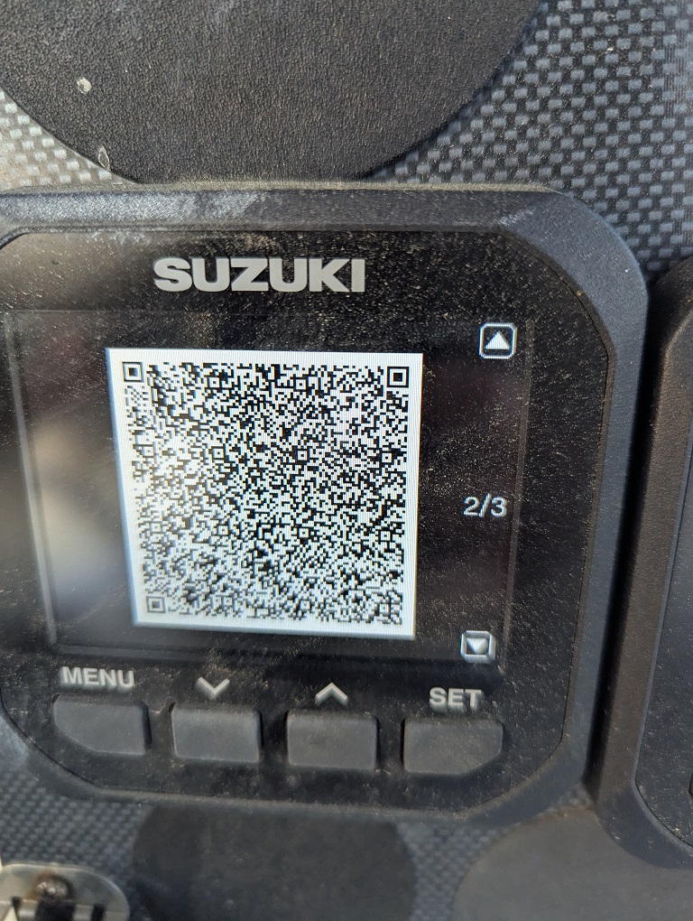

When cold the port engine will start and run through all RPM ranges up to WOT normally. It will run at 4200-ish for long periods of time (tested up to an hour) with no issues. The issues occurs after 3-5 minutes of running at WOT. The engine will begin to stumble and surge, dropping RPMs down to 3000-4000 and bouncing around. Once it starts happening, you cannot get engine back to WOT. If you go back to idle, you can slowly raise RPMs back to about 4200, where the engine seems to run great. It will sometimes stumble in the 3000 range of RPMs, but once it reached 4200, the stumbling ceases. If you then try to go higher, it starts stumbling again. Pumping bulb does not help and VST appears to be filling properly. There are no codes thrown.
