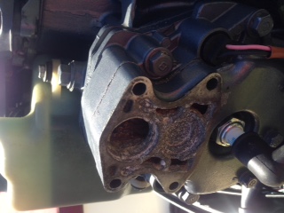

image.jpegGot all my gear ready to do the helicoil and I thought two questions :
1. Do I put the helicoil at the bottom of the thread hole ( bolt thread is 40 mm long) or top , because if you look at the pic , the bolt binds the two parts together the cylinder head and thermostat housing ??

Take a punch or a bolt that fits just inside the threads and push in the tab should break off. I wouldnt worry if it falls in the water jacket if the hole goes all the way through. Unless you can snap it with needle nose pliers?

You want the coil one half thread past flush with the surface then snap off the tab. Your gonna want to remove the water jacket cover to get the helicoil at the correct depth in the head. Your putting in a new thermostat may as well get the new cover gasket and put it back together correct. Have you done a compression test? It never hurts to install a new head gasket while your there.
