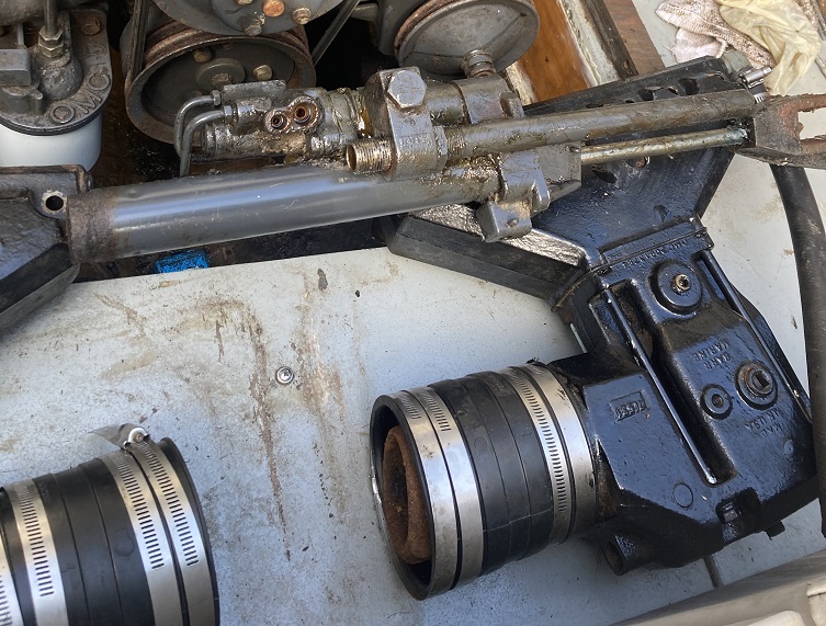

That, or just bit the bullet and pay to get it done. Here's pix from my ordeal replacing the steering actuator. You can see I removed both exhaust manifolds to get at it, it was tough getting at the cotter pin under the steering arm to remove the cable end, but even tougher to remove the 2 big cotter pins that retain the bolts that hold the actuator onto the inner transom plate. My steering cable was still OK when I did this job (2021). I had to use a cotter pin extractor and various other tools to get those big cotter pins out. I lubed everything with Evinrude triple guard grease in case I ever have to do that hateful job again!
Problem solved after half a year. After changing the helm, steering cable, and steering pump, it became clear that the final issue in the system was the steering actuator. It turned out to be the worst part, both in terms of cost and the labor required to replace it.
To install the new one, I had to pull the boat out of the water and place it in dry dock. I had to unmount a lot of components just to access the actuator. Half a day was spent fighting with the pin, it was so badly stuck that it had to be cut. Once that was done, the new steering actuator was installed.
Now everything is working great!
