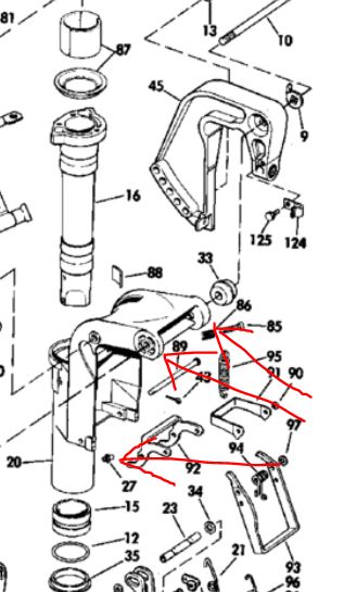

I was going to take pictures of my 9.9 last night to show the locations of the grease zerks but didn't get a chance. If I recall correctly there should be zerks at the points where I've drawn red arrows. I'll look tonight to be certain. In Fdrgator's defense, these motors don't necessarily have a tilt tube, but they are lubricated in the same locations where the pivot tube attaches to the stern bracket.
Try greasing things first to see if it helps. If that doesn't solve the issue it will have to come apart. I've never done this, but from the diagram it sure looks like the powerhead, gear case and just about everything else will have to come off to make this happen.
