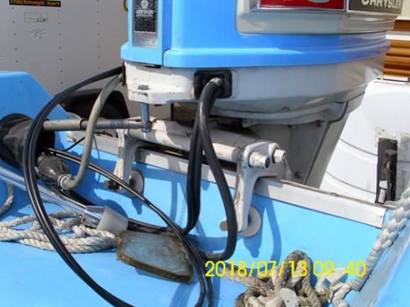

I am new to this forum and I recently purchased a 1975 Chrysler Bass Pro 16 with an 85 Force Outboard. The steering is Gerry-rigged with a bolt. It works; but I need info or a photo of what or how the steering cable connects to the outboard.
I have not been able to upload a file; but basically there is a 3/8" bolt inserted in the support plate hole allowing the steering cable to be attached. However, there must be another part that is inserted in this hole.
I would appreciate any info - especially a picture.
I have attached a photo.
Ayuh,..... The end of the cable should be mounted in the tilt tube, with a link back to the tiller arm,.....
