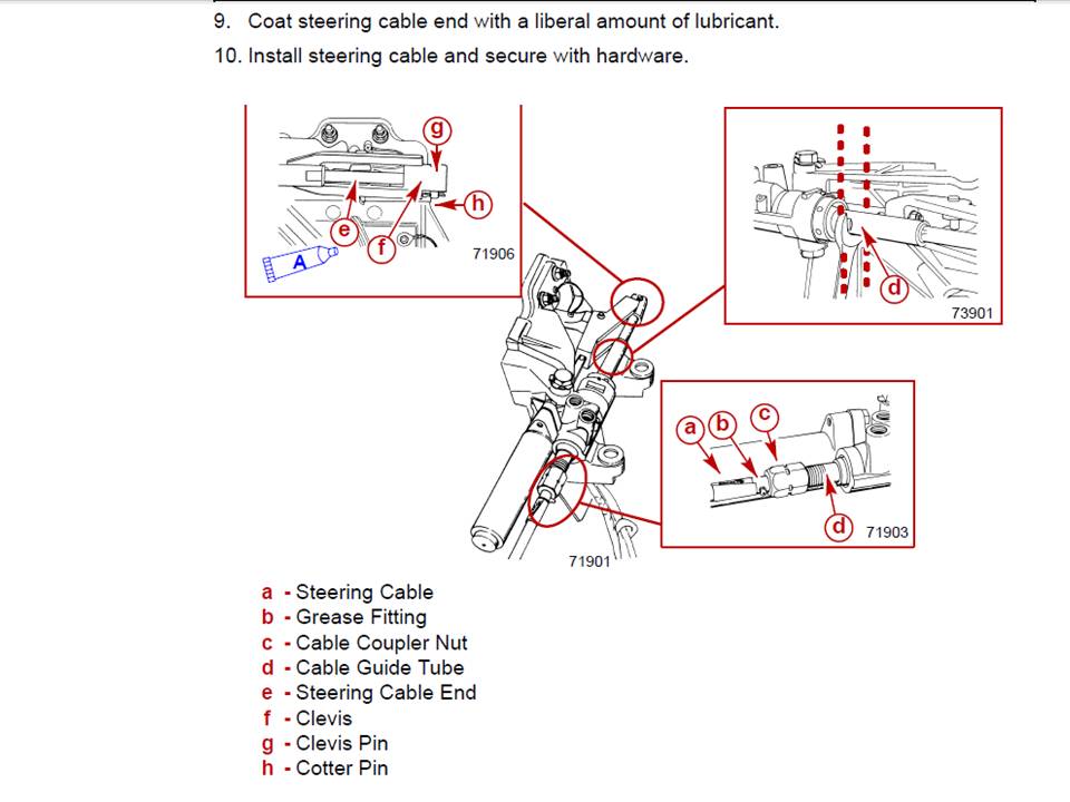

I am trying to remove the steering cable from the tube in a 16’ Larson Citation inboard/outdrive (mercruser alpha). I have loosened the cable nut but as I try to remove it, the cable body twist with it and I would not like to destroy the cable until I have things (tube and outdrive) freed up to see what is not moving. Should not the cable nut turn separately from the cable? Is there a way to free the nut on the cable?

Are you holding the tube with a wrench (Fig d)?
The nut is loosened from the tube and the tube is secure and not turning. The nut seams to be stuck to the cable and when turning the nut (tube is not rotating it is secured) the cable turns with the nut twisting the cable. I can not get the nut to turn without turning the cable even if I hold the cable crimp area with pair of pliers, Also note that the crimp area does not appear to have a grease fitting. No grease fitting on cable side of nut.

Need to get the cable out of the power steering ram first. You said the end won't come out of the ram
The nut should spin freely, but even if it was doing it now, you still need to get the end out of the ram so penetrate can be used inside the cable
You won't be able to apply to much heat to the ram, but can do it on the cable end. Once the end comes out, then you can try and free the cable inside. Even if/when its free, I do not believe it will free up enough to reuse without a lot of steering slop
