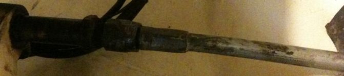

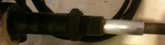

Attached are pictures showing both side of the steering rod (Seal on LHS). Apologies for the scum and dirt shown in these pictures.....
THoughts?

Update.
I now know what the helm is.
I contacted my local outboard dealer and helped me out.
I have decided to replace the cable and steering mechanism in the helm.
But, I cannot completely remove this cable from the motor.
Attached photo shows how close I am.
Tips to extract this final bit of cable from motor?
Will this motor still be intact and connected to the midsection after the cable is removed?
I woudl hate the motor to fall on my legs/feet.

If you just bought this boat and trucked it accross Auzy land , it must have been a good deal-----------------I am guessing you bought someone else's problem , and nothing to to with trucking it.
Looks like someone has used a hammer on the side where the steering connector goes to the engine. The end-eye has been deformed.
If possible, try to force the cable back in again, take a grinder and cut off the end piece with the eye, then pull the remains out.
Nothing will happen to the engine as long as you do not damage the tilt-tube.

The tilt tube is the tube going through both engine brackets which the engine swings around when tilted.
Normally the cable enters from STB side and is attached to the tilt tube with a big nut.
Goes through the tube and comes out on port side ending in an 'eye' where the steering connector goes.
Normally you remove the cable by removing the steering connector on port side from cable, unscrew the not on STB side and just pull out the cable.
However it is a tight fit and if the end tube of the cable is slightly bent or 'someone' has smacked the end piece with a hammer or similar, it might be a problem getting it out.
Don't worry, the only part that belongs to the engine is the tilt tube with threads (Both stb and port side) which the big steering cable nut is attached to. Whatever comes out on both sides of this tube are cable parts!!
Thanks.
I was able to extract the whole lot without cutting anything off now.
I will now uninstall the entire cable, measure up and obtain a new one.
Tips/traps for next steps (i.e. uninstall, ordering correct length, type, etc..)?
