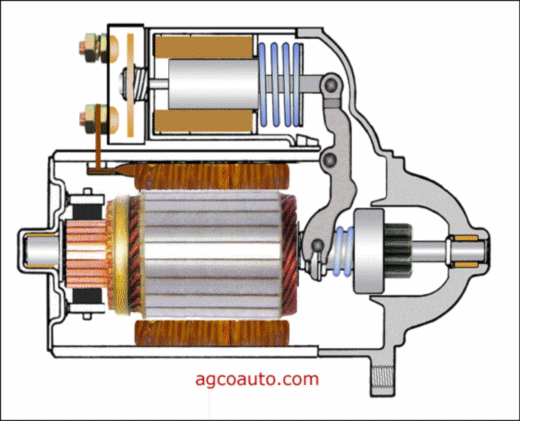

The solenoid disk and contact points have bad spots. The contact points go to the battery cable or the starter. When you energize the solenoid a copper disk that spans the two contacts, moves to touch the contacts and initiate electrical flow. It's high amps, and the disk and contact points get pitted. The disk turns slightly each use so it lasts longer. Once the points or disk is pitted, sometimes the solenoid won't make contact. Sometimes the high amp flow will cause the points weld to the disk.
The fix is a new solenoid or take the solenoid apart, file the points and disk down to unpitted metal.
