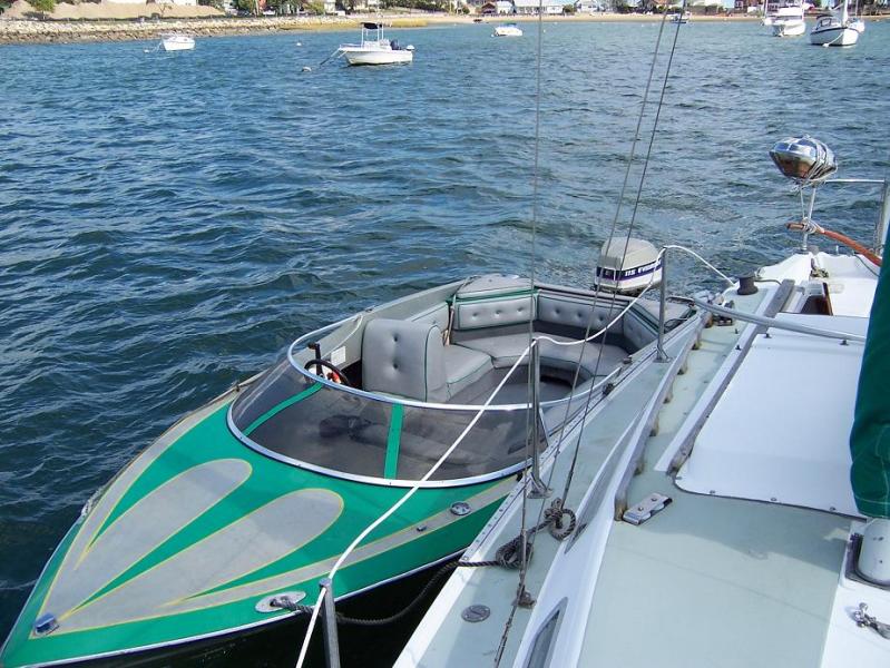

I have a '75 Evinrude 115 on my Sidewinder, it must have well over 2000 hrs and it runs perfect. Nice to be TX it has been cold and snowy in MA this winter. 100_4224.jpg

Good looking rig. Got pictures showing a rooster tail!
