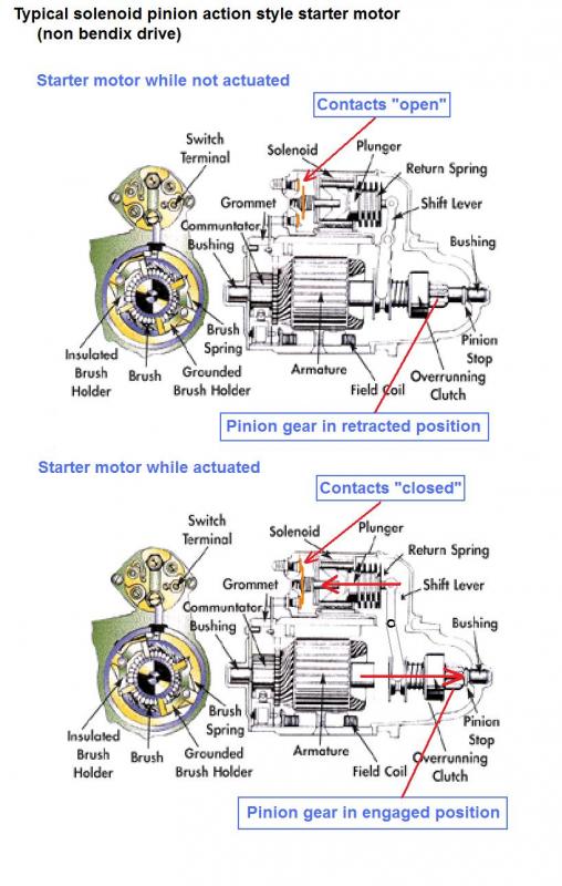

Starter spins fast but not engaging the flywheel .
Unlike a Bendix Drive starter motor, these use a Sprague Clutch arrangement at the pinion gear.
This is a one-way clutching device that allows the pinion gear to be armature driven in one direction, and to free-wheel if it was to remain engaged in the ring gear.
I wonder if it's possible that the Sprague Clutch is bad.
