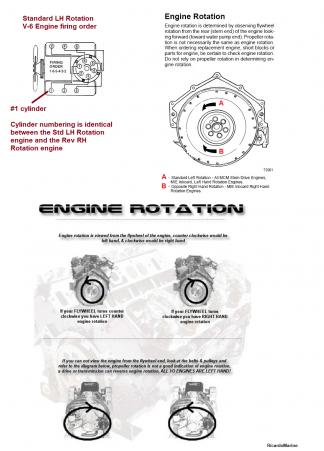

If it is still in the Crusader factory configuration there's only one firing order, which you showed above, for the RH engines.
Just installed the rebuilt starboard Engine after it was seized.. was curious - manual states a firing order of 1-2-3-4-5-6 for the 229 reverse rotation.. the whole Engine turns the opposite direction ..
See images below. (I've added some firing order info to existing images)
i have read there are variations on the cams / firing order.
A few FYIs for you:
NOTE: all engine related indexing is based on #1 cylinder's piston being @ TDC C/S! (C/S = compression stroke)
The crankshaft (on either engine) is the same between the Std LH Rotation and the Reverse RH Rotation engines.
The Reverse RH Rotation engine Int/Exh valves must now operate in sync with the Reverse Rotation of the crankshaft, rods, pistons, etc.
In order to do this, the camshaft profile is designed to work in sync with the crankshaft that is now being rotated in the opposite direction.
In other words, where we would normally see #6 cylinder following #1, we now see #2 following #1, and so on right down the Reverse RH Rotation firing order.

Keep in mind that the ignition distributor rotation is the same between the two engines (i.e., RH and LH rotation) due to the oil pump rotation, of which is always standard.
Looking at the distributor cap (and knowing the rotor rotation), make sure that #2 follows #1.
Continue this right down the Reverse RH Rotation firing order.
Unless Crusader has reason for deviating from the Std LH Rotation Engine ignition advance specs...... the Ignition advance will be the same for both Engines.

I would say doubtful!
