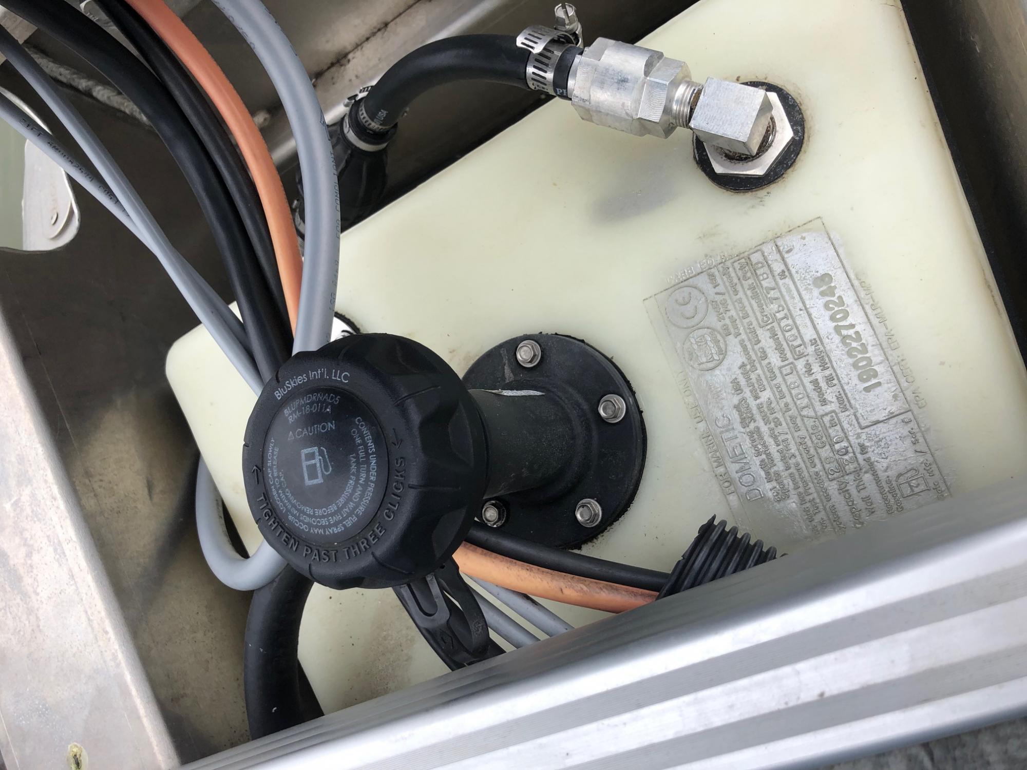

We have a 2019 Crest pontoon with a Mercury 60hp Command Thrust motor.
No problems the first two years and then late in the season last year, noticed that the boat would want to stall if RPM's were above 3500.
I did the following:
new spark plugs
new low pressure fuel filter
new high pressure fuel filter
Winter storage was outside with fall maintenance:
Change oil and filter
Change lower unit oil
Add Marine Stabil to fuel (1/4 tank, about five gallons)
Fogged the motor
Started it up in the driveway yesterday and it fired immediately and ran perfect at idle.
I dropped it in this afternoon and it again idled perfect until I increased RPM's to about 3000, where this time it promptly stalled.

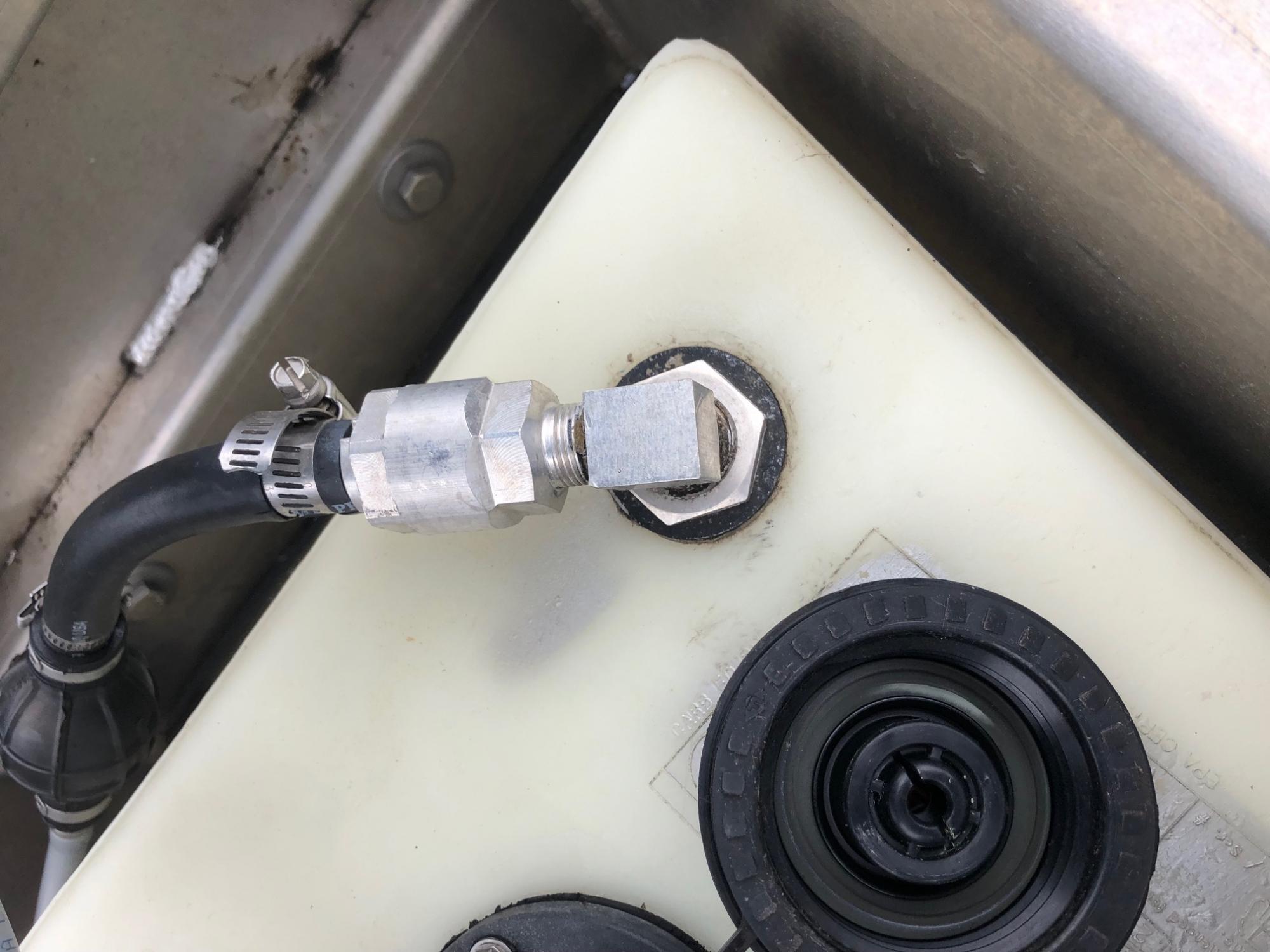

It took awhile to start it again and I loosened the fuel cap and noticed air escaping so I know I had pressure.
I tightened the cap, squeezed the pressure ball about three times and it started again and I idled back to my dock with no issues.
I'm a bit stumped at this point.
Appreciate any guidance.
