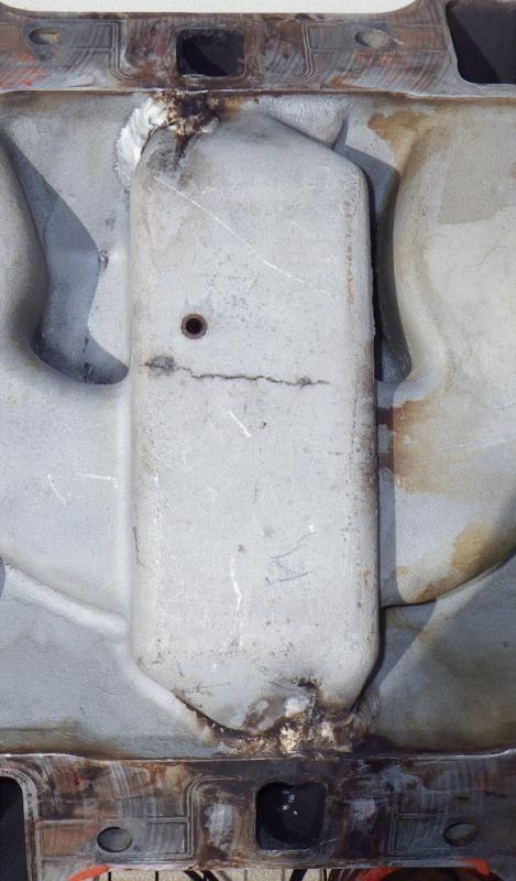

The video doesn't look like a single plane Torker intake to me. Looks like a dual. The Torker is more of racing manifold with a 2500-6000 rpm performance range.
Check this repaired dual plane Eddy CH4B. I'm thinking this got just too hot in the crossover. Flanges are flat within .002". Engine it cam off ran just fine...........................
It is an Edelbrock performer intake manifold (basically stock)because I wanted maximum torque. Hopefully, I will be able to do some tests this weekend. Edelbroch tech guy did not give me the parts that you recommended. He swore that it is a jetting problem. They want me to measure the intake vacuums to make sure that I have the correct springs on the step up needle jets. I have a jetting kit, Edelbrock heat insulators (3/8"), and rebuild kits for the gaskets. I will keep you posted.
