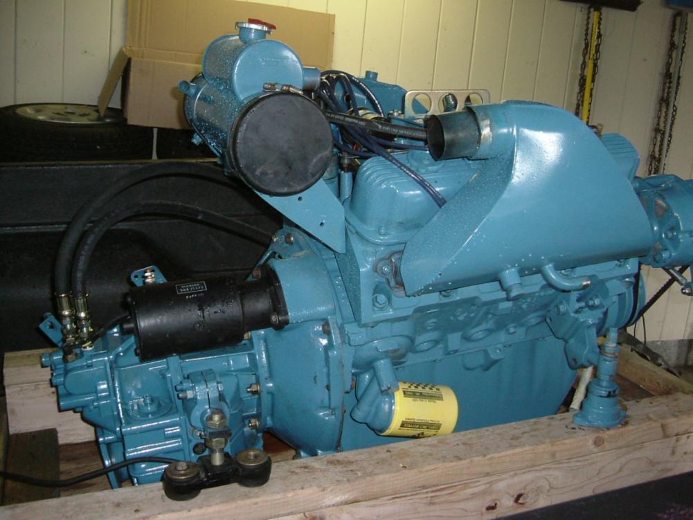

Here's trying to send some pictures of the manifolds as they were a while ago. They're different now, the fresh water inlets are on top instead of the side on both

You're welcome. I can take more pics if there's something you need to see in detail.
