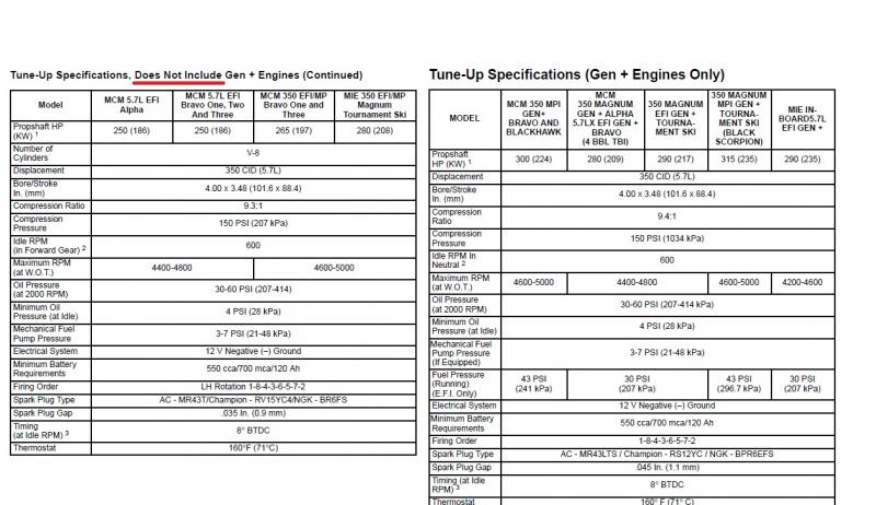

I was told that the vortex motor the gap should be 50-60, just tryn to find the actual gap for this motor. There is iridium plugs in the motor.
You need to identify if it is a NON GEN II or a GEN II engine.
Non Gen II have 12 bolts to intake manifold.
Gen II have 8 bolts to intake manifold.
Here is what the manual specifies,

Nut shelling this, your ignition system (secondary coil voltage and amperage), fuel/air mixture, cylinder pressure, etc., will all determine the gap between the inner/outer electrode.
For example...... a .050" or .060" gap would be used for a HEI or high output ignition system.
https://www.briskusa.com/spark_plug_gap_spark_plug_gap_chart
Disregard that post.
You gap your spark plugs exactly to the OEM manufactures specifications. END OF STORY.
