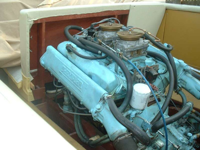

My 1963 dual quad 426 is very tilted and it has no issues with plugs. Remember the intake manifold is under a vacuum.
