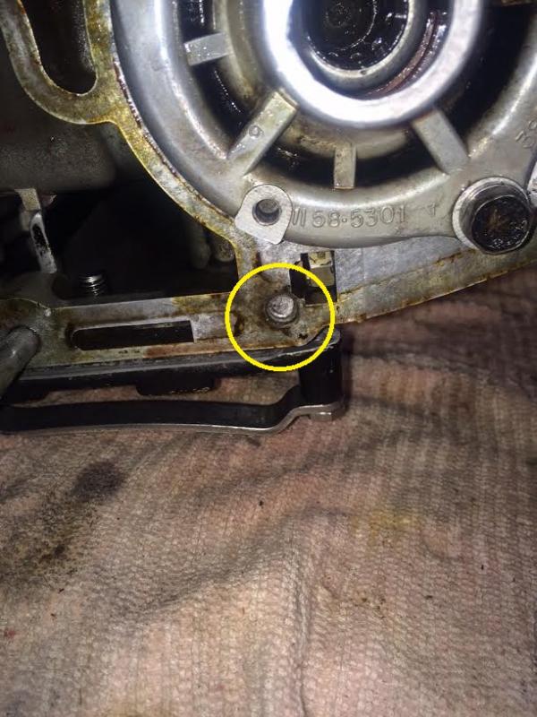

Put the powerhead back on my rebuilt 1974 Merc 500 50hp. But I hadn't torqued it to spec yet as I had to figure out how to do that with the limited torque wrench I had. Tonight, I go to torque and everything is going well until the 3rd stud. It snapped. Ffffff me.... I hadn't even gotten to the required 15 fp. So, off comes the powerhead with all the ruined gaskets that will have to be replaced and surfaces re-cleaned (used Permatex aviation to ensure a good seal) and new gaskets ordered along with a new stud -- probably from eBay. I wonder if I should replace all the studs to mitigate this happening again? What do you think? Meantime, I have to get the remaining stud out of the block without screwing something up further. This makes me nervous. So much work to restore this motor.... Any good advice getting this stud out without doing more damage? Other good words? Thanks all...
If it snapped off flush with the surface you have a real problem. (If not, try working it back and forth with Vice Grips.)
The usual removal method is to center punch it and drill most of it out, then using an Easy Out (or collapsing the shell of the stud inward with a punch). If you use an Easy Out, be damn careful not to snap it off or....

Then I have a real problem. It didn't just snap off flush, it's just inside the hole where it's seated. I assume I will have to take this to a machine shop to drill and back this thing out? No way to re-tap it, of course. I swear, to get this far rebuilding this thing and this happen.......
Take it to a machine shop.
I'm wondering.... There's only maybe a quarter to a half inch of stud in that hole. If I drilled into it (without going all the way through it!) and used a reverse bit or easy-out with lots of heat on the aluminum block (since the stud is steel and will expand slower), I wonder if I could carefully back that out? Worth a try or not worth the risk??
BACKED THAT BROKEN-OFF STUD OUT with a fluted bit! Now waiting for the replacement I got on eBay for $5. Gaskets not ripped (though coated with Permatex Aviation Form-A-Gasket) so I hope I can re-use them.
