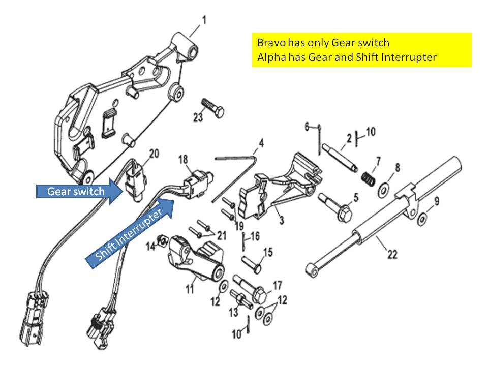

Look on the shift plate to see if there is a in-gear switch
If one is there disconnect the switch after motor is started
If one is there disconnect the switch after motor is startedView attachment 34164
With a 496 CI engine it has to be a Bravo.
