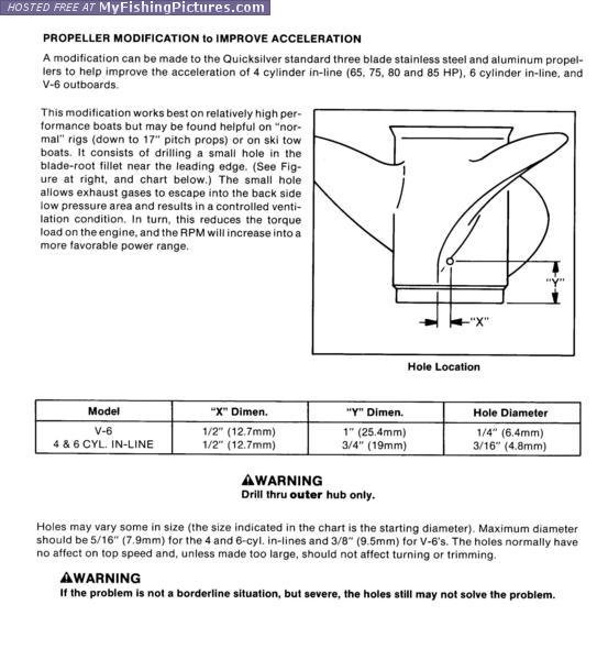

You can also drill ventilation holes in your prop body for an improvement in hole shot. The exhaust gasses pass over the prop blades and cause a "controlled ventilation" which allows the motor to spin up faster, getting into its power band quicker. I've attached some info on that.
HTH.......ed
