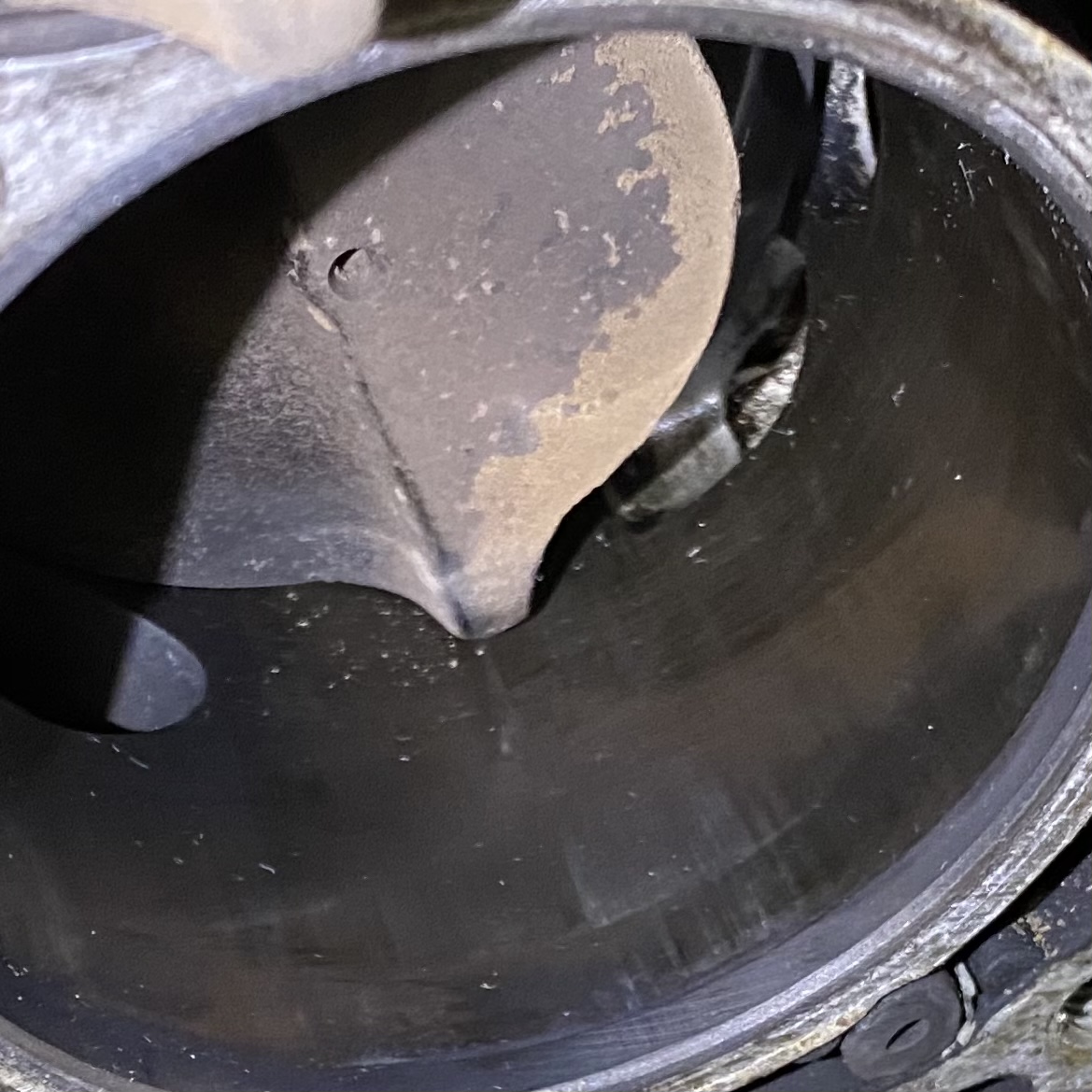

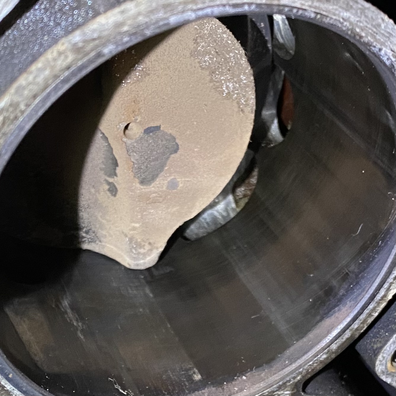

I think I either sucked up some schmutz or lost prime on a turn and cooked the impeller, housing, and housing spacer. The powerhead seems to be a different color now too.
Compression is down to 60 and 56. I imagine I'm at least looking at a head gasket and water cover gasket. What else should I be focusing on as begin the teardown of the powerhead?
