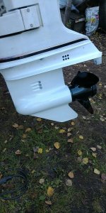

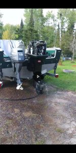

Here is a big Optimax. Shaft was bent to .055....The guy backed into a rock pile. Skeg was bent beyond my repair standards....so I welded on a new one....didn't take apart case, and straightened shaft in place with a trade secret proceedure. This is $1000 repair.
Am I showcasing my work? ......maybe.....but if some hillbilly from nordern Minnesota can produce this kind of work on the top of a 55 gallon drum in front of his pole barn......then a "real" shop should have no excuse.
