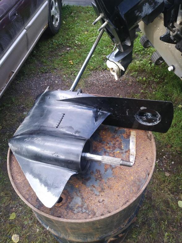

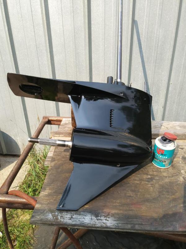

Here is a before and after of a 135 OptiMax I did recently. Should notice that the guy backed into a rock and bent the shaft too.
