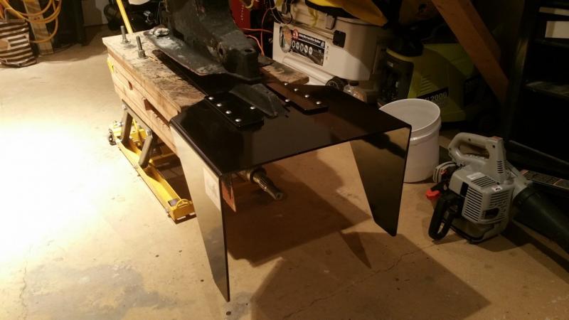

The boat is a 25' deep V hull, single leg bravo iii with trim tabs. issue: at idle and low speeds under plane the boat will wander right to left requiring constant attention. I have purchased and will be testing this add on in the next couple of weeks. I will report my findings. Has anybody seen or used this type of product. it is marketed as a wander fix.

Ayuh,.... That looks like a drive Buster,......

Reporting back on the low speed wandering issue I was having. My first posts shows pics of the Orca Fin installed on my drive. I have been out on the water 6x’s since the addition of the fin to the drive.
Problem:
Slow speed wander. I have a good 1 mile run @ 6mph in no wake zone from the dock. I also do a lot fishing, trolling at speeds of 2 - 5 mph. The boat is located on Chesapeake Bay and I have to deal with winds, currents and tides.
Boat:
25 ft. cruiser with single screw Bravo III Merc, 350 mag., Deep V hull with hydraulic trim tabs.
Post Operation History:
In no wake zones, drive down, trim tabs down, I would correct every 20 to 40 yards, hands near the wheel at all times. Around docks there was a lot of forward-neutral action to tie up. Trolling in open water when not at the helm and working the wheel the boat would try to circle back on my lines in maybe a 100 – 200 ft. radius (wind/tides maybe). Slow speed cruising near docks was an awfully experience.
After install:
In no wake zones, drive down, trim tabs down, I slightly correct maybe every 200 yards even with winds blowing. Trolling open water is a non-issue, the boat holds a straight line in winds and tides. I also plane faster around 3000 rpm. I have filled up 2x’s and approached the gas docks in straight lines. My own dock requires me to turn 180 in a tight space to tie up. I feel as though I am not drifting as much also. Even with winds blowing. I am also experiencing a much smoother and more confident ride than ever before. I am very pleased with the addition to the drive.
