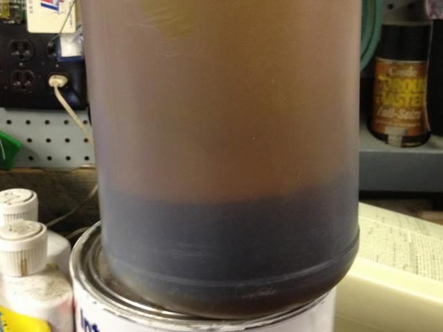

Just for informations sake, at the start of each season I hook an electric fuel pump onto my tank with nothing else in between. I will pump out 1 gallon of fuel and usually end up with a quart of crud. Remember that ethanol is our friend. Not! That and changing the filters and water separator has work wonders for me.
From what I've seen, that's not ethanol crap (though ethanol loosens up crud like that). The ethanol crap is white, like thinned milk.
