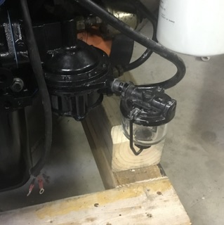

Hello everyone, Can someone please help me I’m wondering if the glass sight bowl on the fuel pump is for water condensation or is it a gas filter. It’s on a 1977 351W. If it’s is for gas I would need to know what filter would fit it. It never had a filter in when I bought the boat. If someone can help it would be greatly appreciated.

that amazing item is a "tell-tale" it alerts you to a ruptured diaphram in the fuel pump. Newer pumps us a Tygon hose up to the carb in case of a diaphram failure
