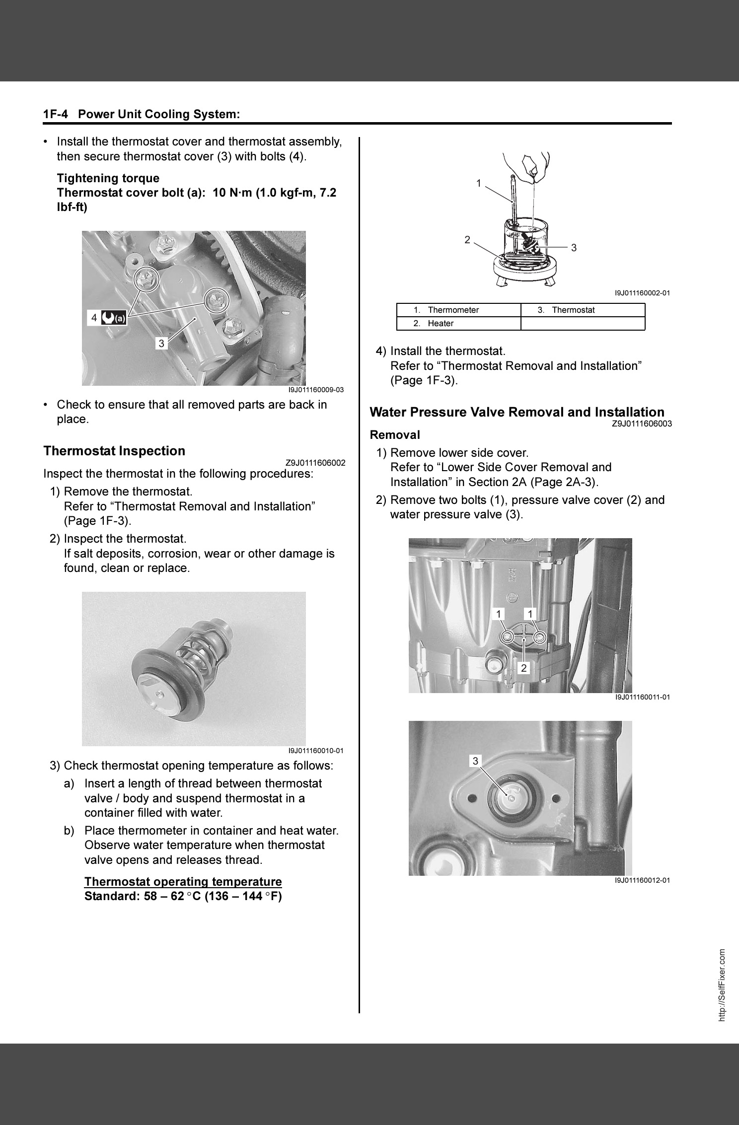

W William01 Advanced Contributor Mar 9, 2026 #2 Online Service/Repair PDF Manuals www.selffixer.com For $11 the service manual(pdf) will answer all your questions. My poppet valve (2009 DF90A) is on the lower unit. Not sure if the earlier, pre A series have the valve in the same location.
