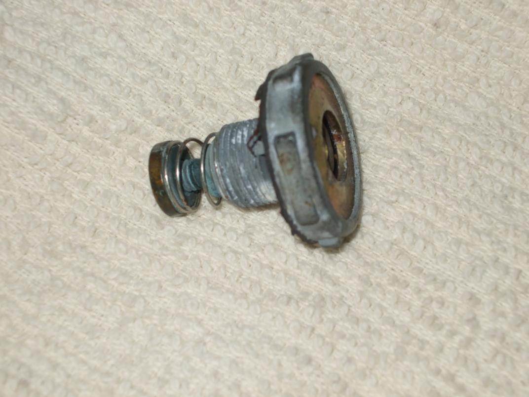

I found this near my battery compartment... might be unrelated. Any ideas on what it could be?

No idea what that part is that you found, still say that 95 is going to be cone clutch not dog but you still need to check the lube level even if that means pulling the boat out.
