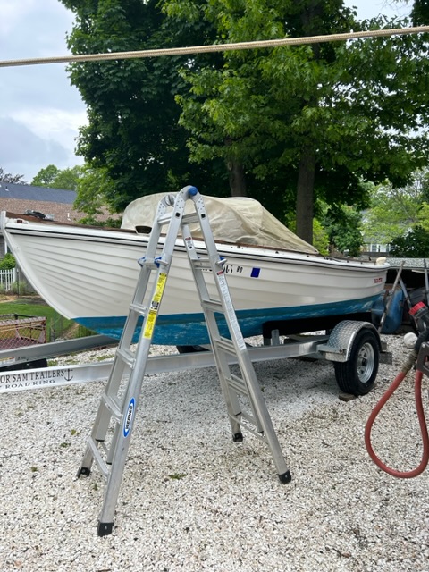

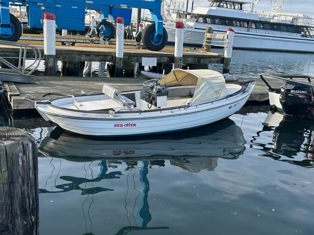

Carburetor filthy, bad fuel pump, cooling passages salt clogged irretrievably on exhaust/intake manifold, thermostat housing, engine water circulating pump, bad bilge pump switch, lift pump electricals corroded beyond salvage, running lights toast, fuel sender and gauge bad, water in shaft bellows, bad lower unit. All fixed and running great right on the numbers at 35kts.1970s sea otter 19' built Bristol RI. Worthy learning experience......hilarious, cool, neat boat. Cosmetics next. Blue boat my 44' Dolphin twin d9 volvos shafts. Cheers
