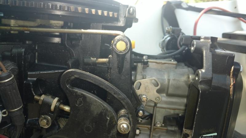

Hi, I have a new to me 87 Johnson and recently rebuilt carbs and replaced water pump. I mounted it on my boat and reconnected the throttle and shift cables. After I finished all that I fired it up and it had a very high idle. Even for starting it in the yard with a flush. Not sure if it was the cable I mounted or the carb rebuild but i guess maybe I didn't put things back the exact way they were took off? I noticed that the cam roller isn't lined up properly with the notch on the throttle arm. Do I need to make adjustments to the carb linkage etc.. or the throttle cable? Thanks for any help!
First, inspect the throttle roller to make sure that the outer cover of it hasn't broken away (if it's a two piece roller). It should be approximately 3/8" in diameter... if not, the outer clear cover has cracked and broken away, causing the diameter to drop to approximately 1/8"... in which case, replace it.
Now, back off the throttle roller. loosen the retaining screw and back it away from the cam so that there is no tension applied to the carburetor linkage.... then adjust the throttle butterfly linkages between the carburetors so that the butterflies open and close at the same time.... You do not want one set of butterflies closed and one ever so slightly open.
What's left is to adjust the throttle roller so that the throttle butterflies just start to open when the scribe mark of the cam is dead center with the roller... not before or after. Secure the roller with the set screw
NOTE: The adjustable linkage between the vertical throttle arm and the cam... DO NOT tinker or attempt to adjust that rod as that controls the "idle timing". If someone changes the length of that rod, it will be necessary to check and re-set the idle timing as per ones service manual. This must be accurate in order for the above settings to be accurate.
Now, with the linkages set properly, adjust the throttle cable at the adjustable threaded trunion that's clamped to the engine. Find the idle stop screw that's somewhere in that vertical throttle arm and back it away from its stop. loosen the bolts that are clamping the throttle trunion to a point where you can turn it. With the engine running, turn the trunion and get the idle to where it belongs. Race the throttle slightly a couple times to see where the idle drops to and adjust as needed.

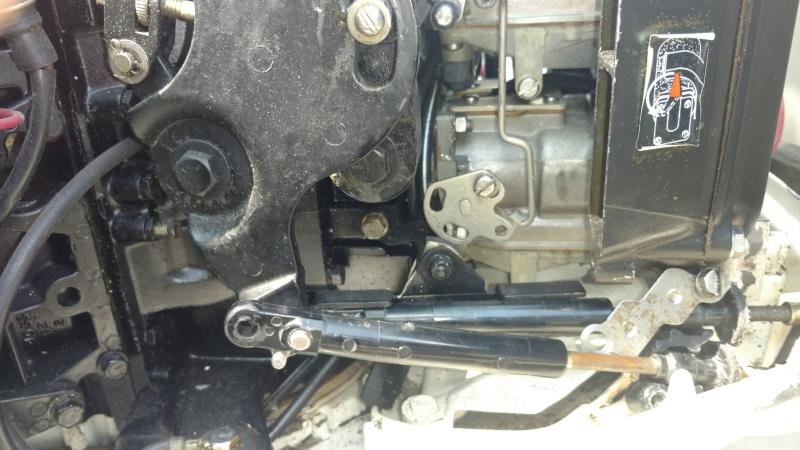

Thanks Joe! I synced the carbs and set the roller on the scribe. What I am left with is a cable that is too long to fit back in the throttle plate. Do I have the cables backwards? Or is there an adjustment I'm not seeing? Is this where I should be adjusting the idle screw at the top of the throttle? Even if I back the trunion all the way till there is no thread showing nearest the throttle arm it still is too long . Trying to cut down picture size so I can post something..
Thanks racer verified that's the throttle cable so it's connected the right way... Adjusting the throttle cable only involves turning the circular plastic part right? Not sure what else to adjust or if the idle was right before I got it
There is nothing left to adjust which indicates that something is not as it should be.
If that loose cable is indeed the throttle cable... I would think that something is not as it should be on the other end.
