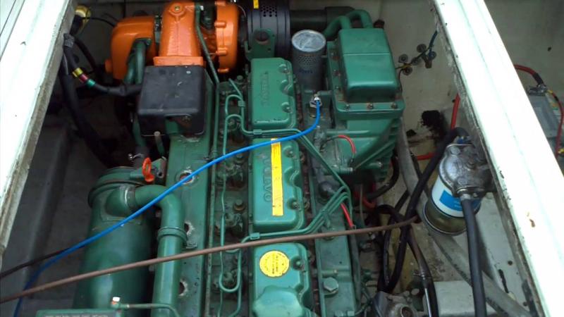

Sounds a bit strange. Is it at the back of the engine? Could it be from the rear oil seal on the crank? Oil gets hotter and under more pressure at higher rpm's, so where else can it come from that isn't visible? Another thought, check the sealing at the base of your dipstick tube. We fixed an oil leak on a KAD32 that took ages to find and found that the dip stick tube wasn't sealing to the block properly.
Of course I could be wrong about your engine! Attached is a picture that is similar to my engine, the oil breather filter is the silver cylinder near the air filter. Of course your engine could be different.
The relief valves only operate if the crankcase pressure gets too high, otherwise you would have no reason to be aware of them, they are not a service item.
