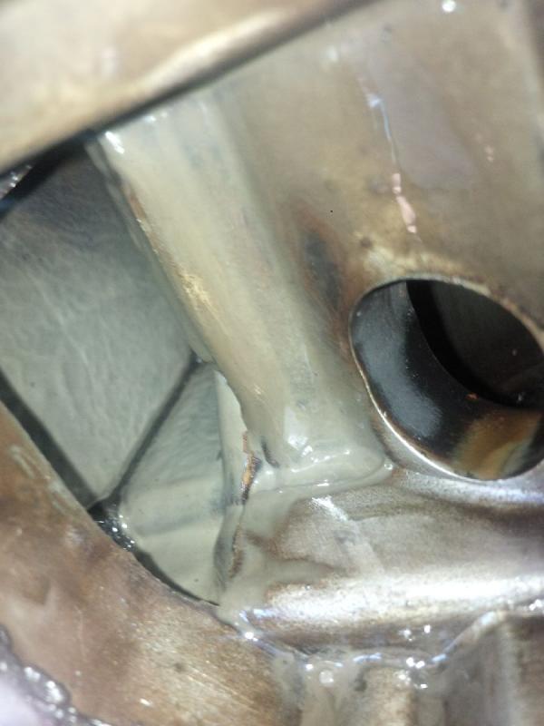

So finally started the engine and put boat on water. It would die instantly when engaging gear. Iddle(air) screw could not be adjusted to overcome this. I then tried to set idle to 1700 and slam into gear to see if idle circuit was faulty but to my surprise it died again. I took boat back and disassemble to motor and I saw water in both cylinders, more in the bottom one. Also inside there was a mucky liquid, something that looked like grease mixed with water. You can see that in the pics.

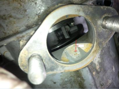

So I opened the crankcase to check again and I noticed the FEY ring on the crank bearing was blocking what looks like a hole that goes from crank to the carb intake. In the pics is noted with nr 1.
Please shine some light on me and explain what does that air passage do and how I should arrange the ring and it has only one hole and on crank there are two, on opposite sides.

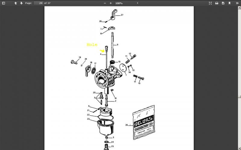

If someone knows please tell me how the fuel travels on this carburetor and how air adjustment screw works. The needle (tube) has a hole that connect the float chamber with the idle(air) passage.

Attached is a PDF that has the schematic for this engine. Altought PDF is 2003 engine and parts are identical.
http://www.somiboats.is/files/partlist/D - ANTIBES 2002-2003.pdf
