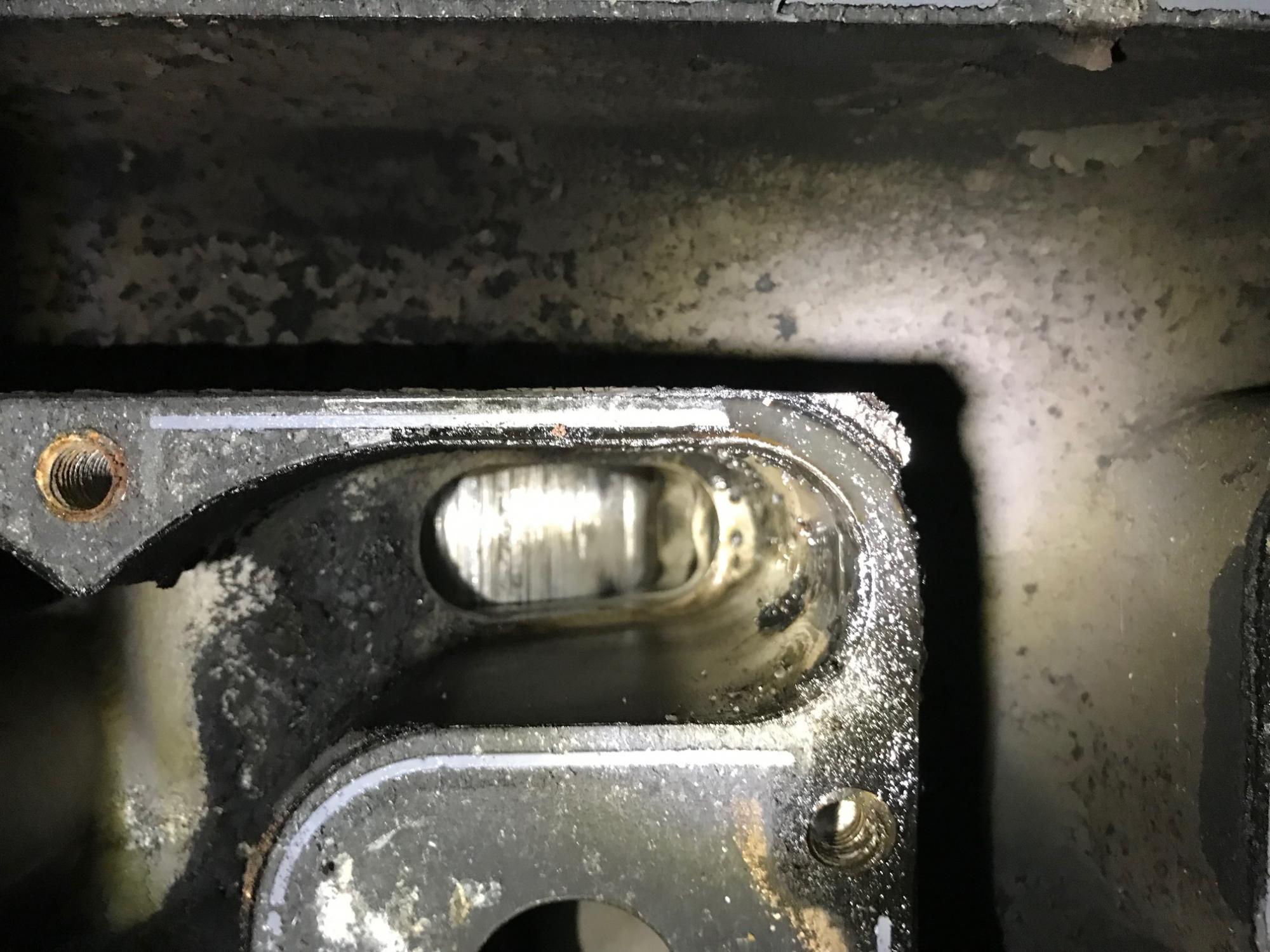

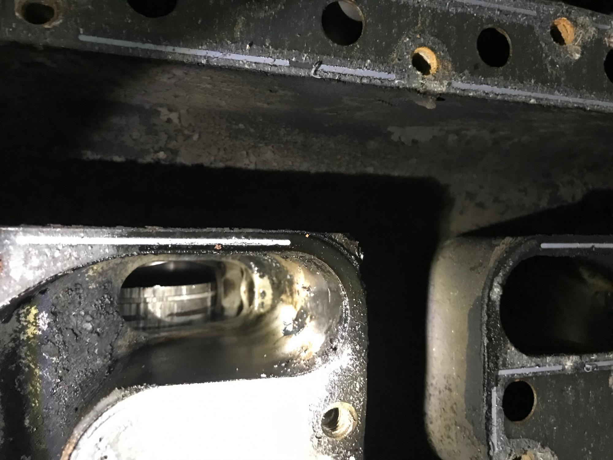

The 100 psi compression is a huge concern.----Deal with that first !----Pull exhaust covers and inspect #2 piston.
racerone, Took the exhaust plate off and you were right on the money. Smeared aluminum in the body of the piston. Some of it is right over the ring and all the way down to the bottom of the piston. I am trying to attach two pics but I am new to this forum so it might not work for me (operator error).

No surprise to me.----Not a hard repair if you can do it yourself.-----Might be difficult to find a shop willing to help you.-----If a shop is willing then the cost might shock you.
If I was going to do it myself it's a complete tear down, new piston, maybe machining or honing the cylinder to clean it up then reassembling the whole engine. Depending on the damage to the Cylinder, would possibly need a slightly oversized piston.
