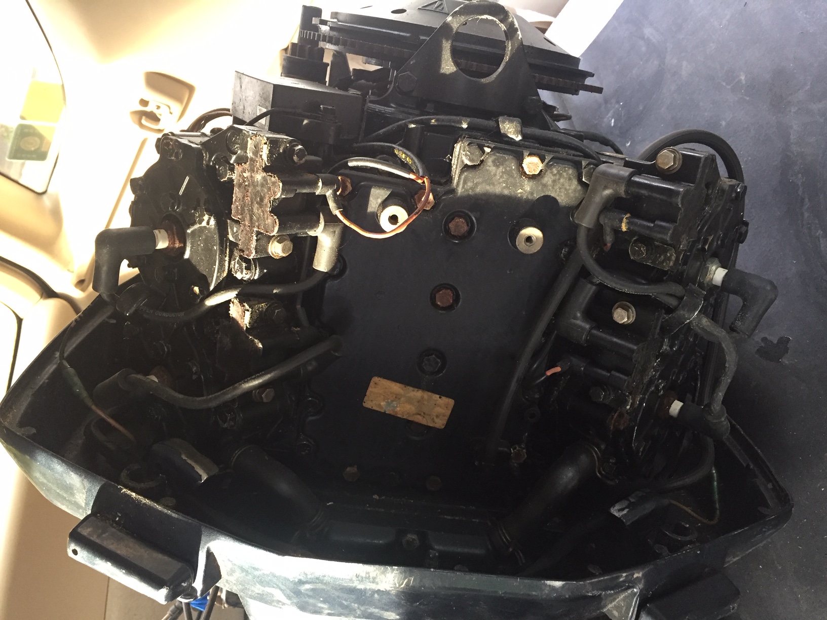

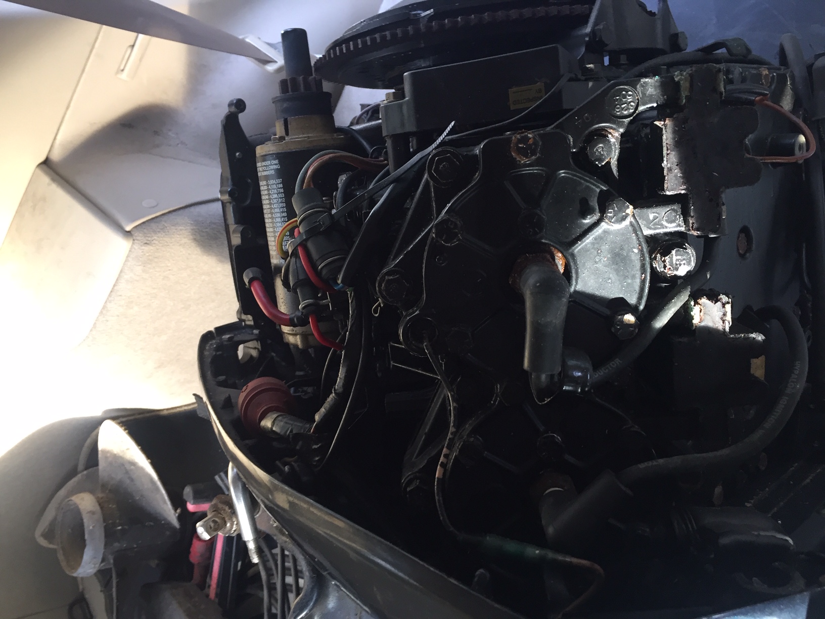

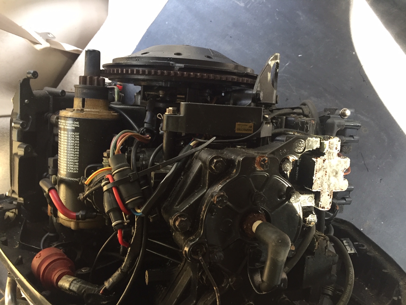

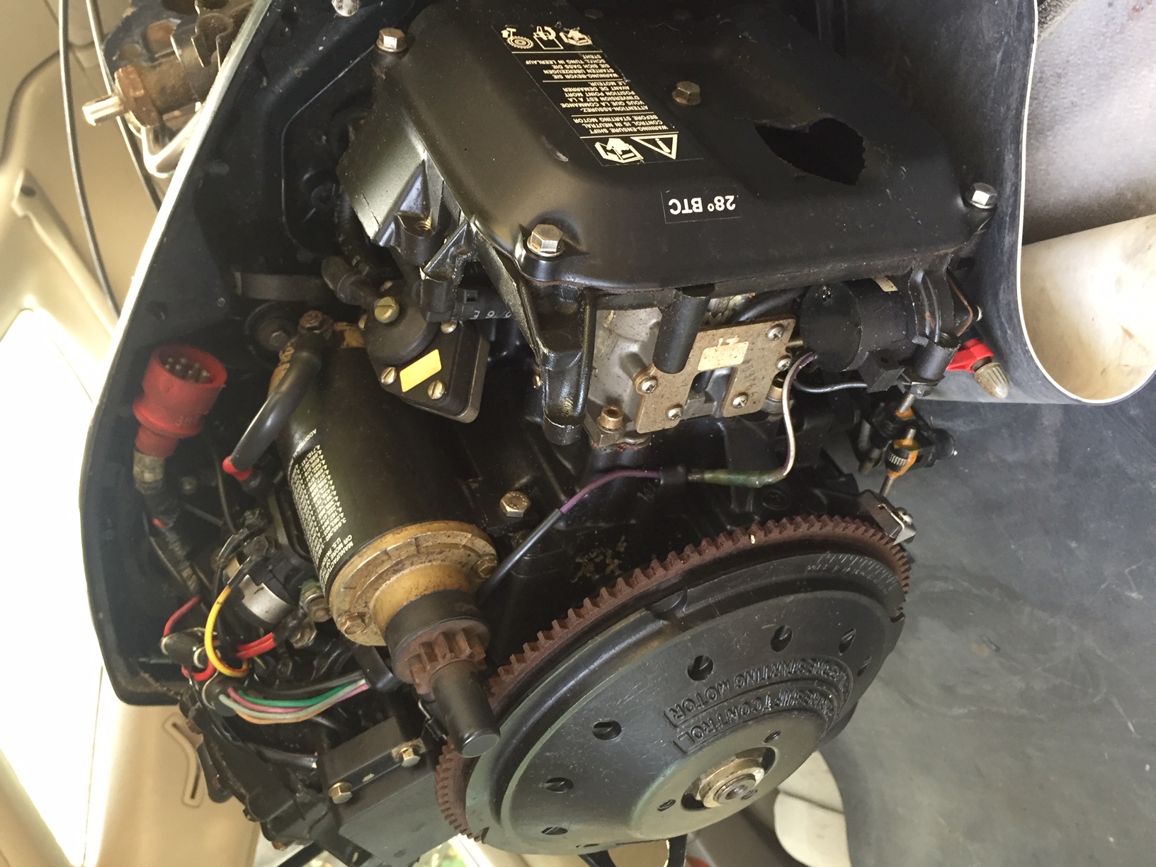

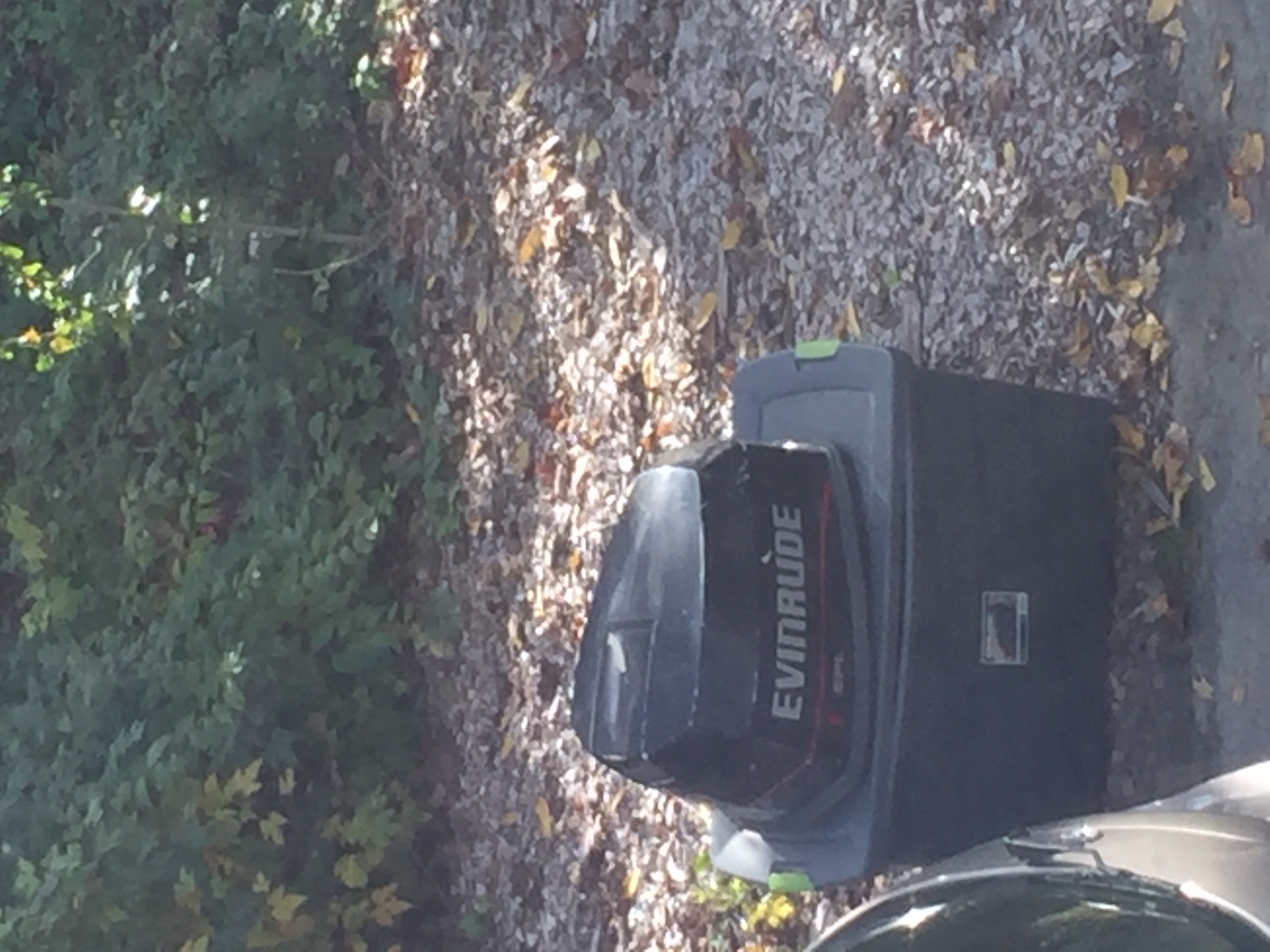

Found a 88hp Evinrude SPL last night. Came with motor, prop, and controls. First thing I noticed... Where does the battery connect? but I have attached pictures and looking forward to hearing feedback.
View attachment 25317View attachment 25318View attachment 25319View attachment 25320View attachment 25321View attachment 25322
Addition pictures attached.

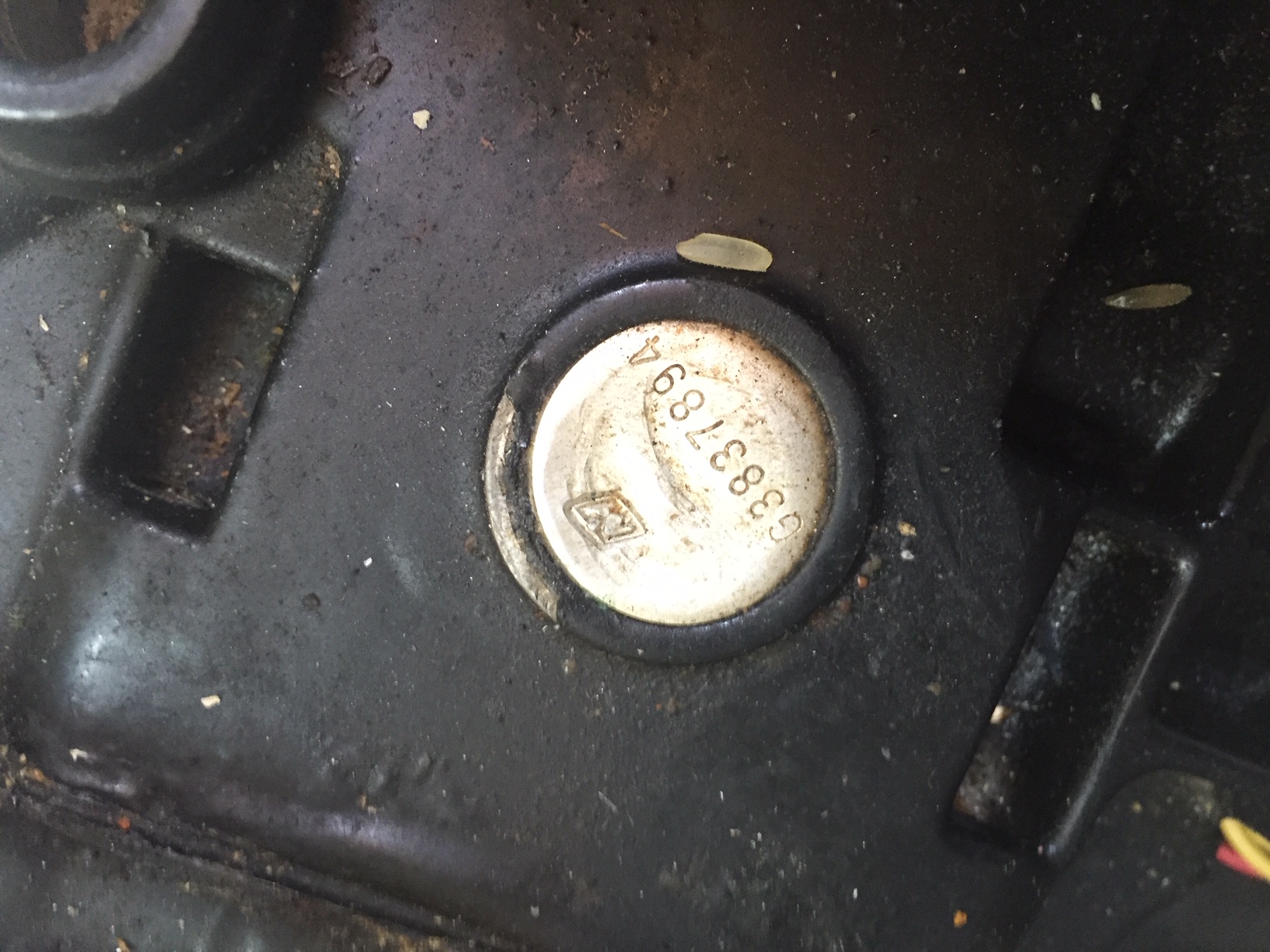

I provided welch plug to give an idea for model. I couldnt find a badge. Where would it be. Please provide obvious... Is this a vro motor?

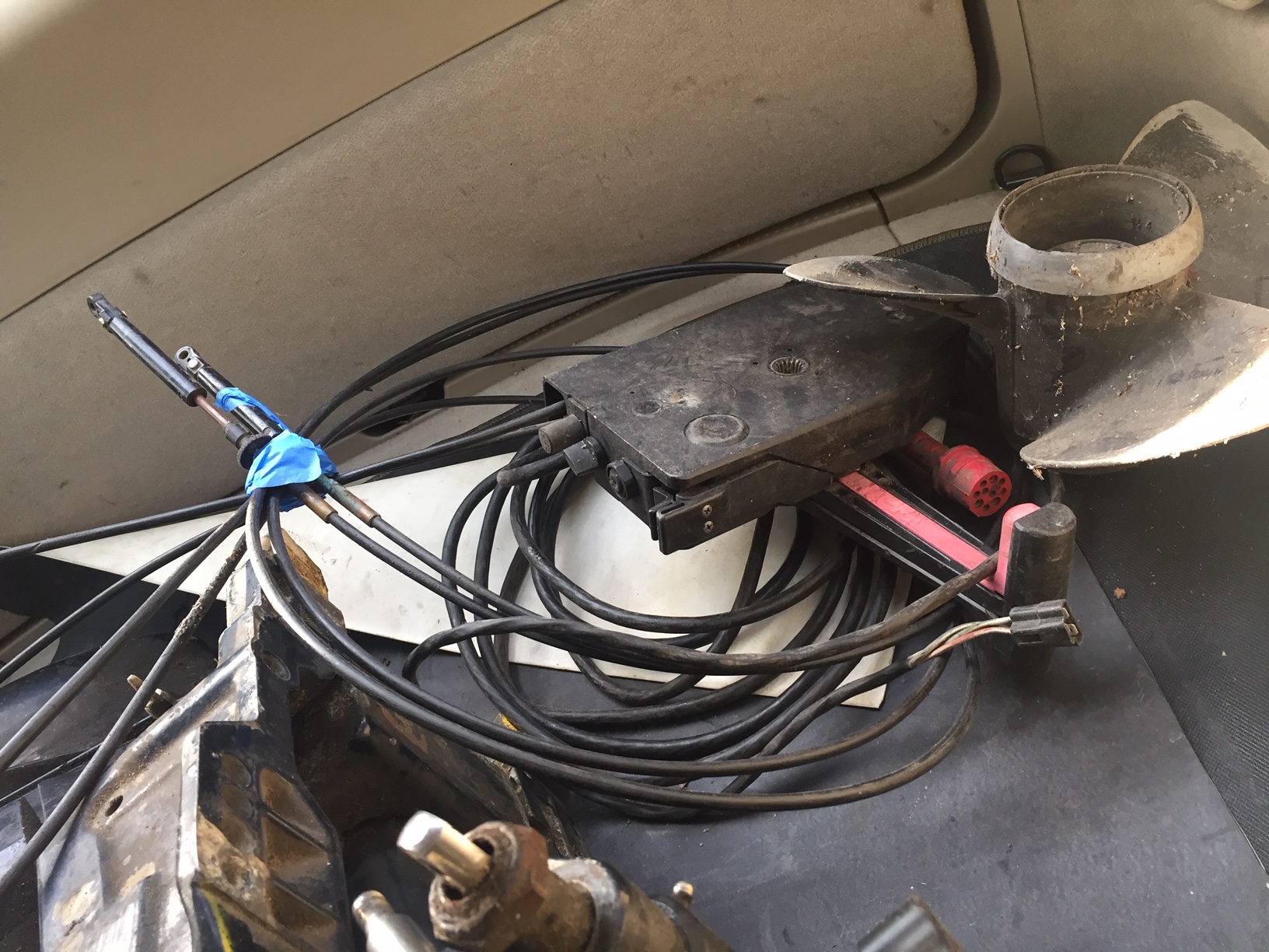

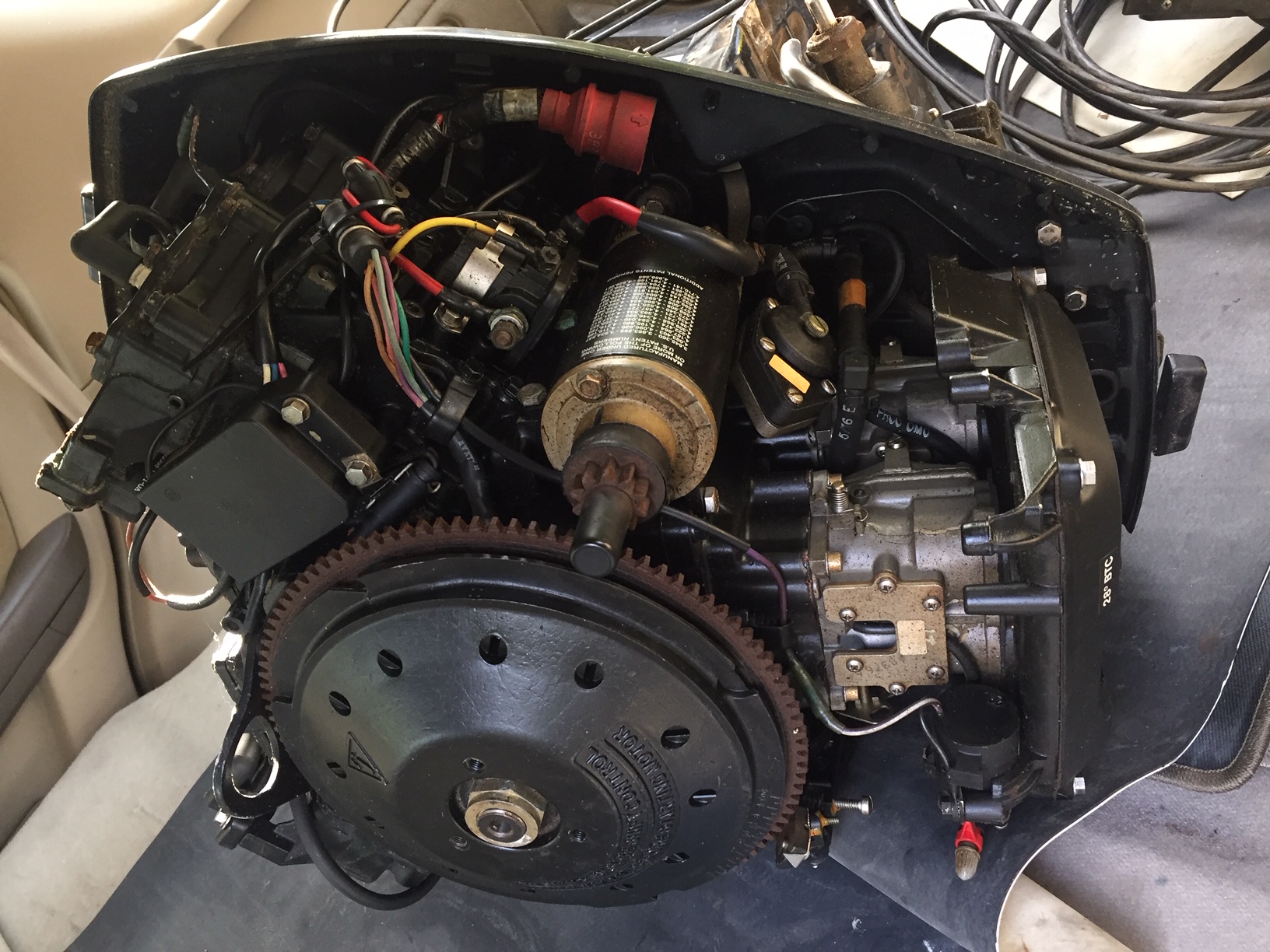

The 88 HP models did not come with VRO.-----But some one could have added it after it left the factory.----Your motor just has the simple fuel pump that can be repaired with a $10 diaphragm.------Not the $600 VRO pump.-----Red + cable goes to the solenoid.---- Negative cable goes to a 1/4" stud on the block with a nut.----Do a compression test on this motor first and foremost.----They are famous for breaking piston rings.

what is the obvious sign? It looks like i have a simple fuel pump and a gas connection on side of motor. I noticed missing bolts on rear of motor and thought What the heck?
i need to do compression test but, where does battery connect, there is no terminals? Are they typically left in the boat?
I know i can rig it from starter solenoid. Correct? would like a year ID.
See post #3 edited.----And what missing bolts do you speak of ?------There is a spot at the back to mount trim / tilt relays .---Also a feature not available on 88 HP models.-----The motor is 1995 /96 model I would say-----

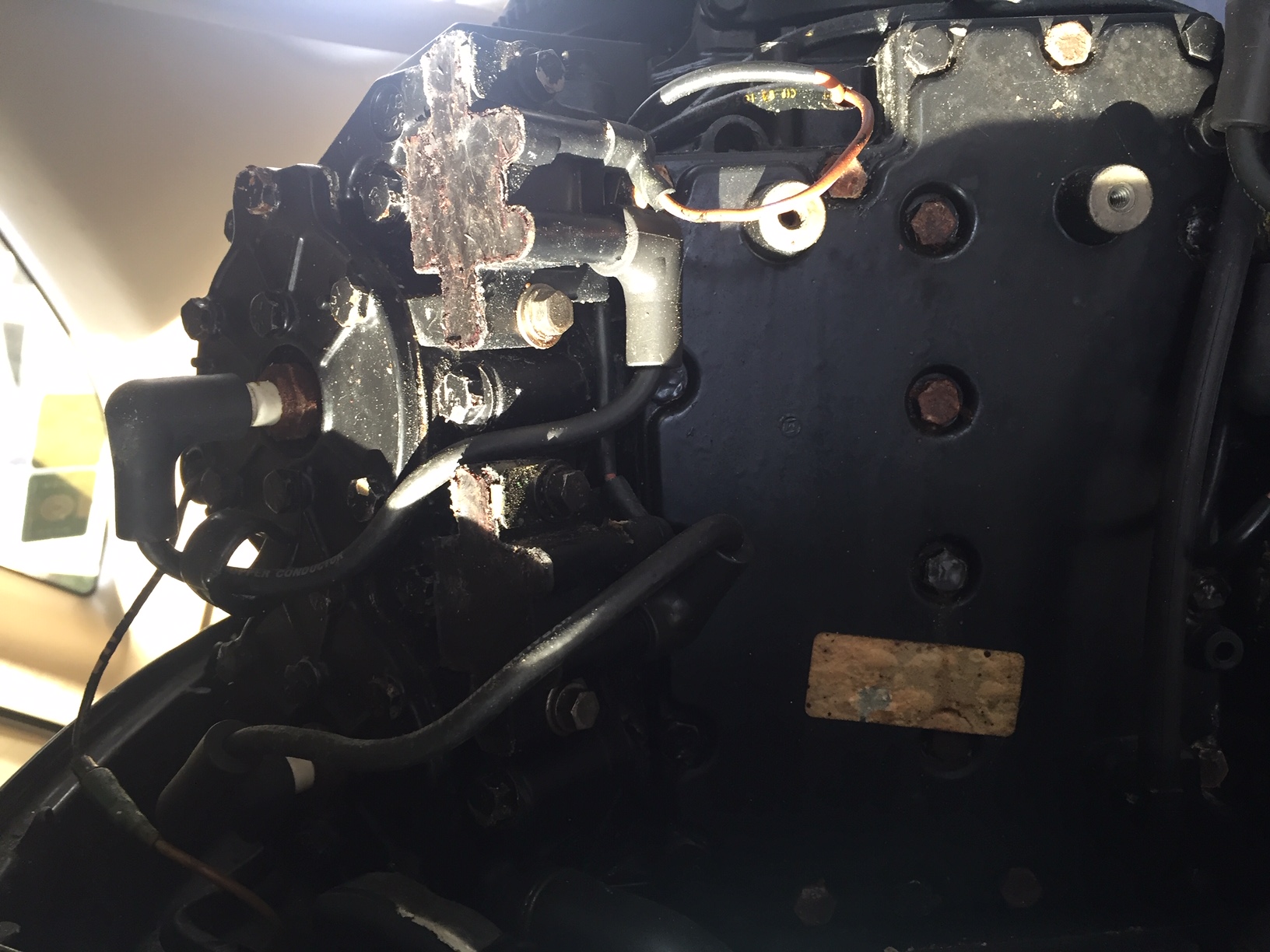

IN your second picture there are two small red wires. If you look just to the bottom of them you will see the spot on the block where the neg cable will attach. It looks like the bolt is missing in this pic.

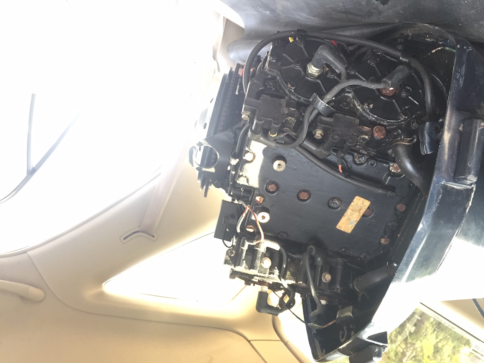

thank you. Pictures 1,4,& 5 show missing bolts. Worried me
thank you I will look into that. This is a heavy motor how do I move this thing lol supposedly the motor ran before it sat. The old famous story.
Those 2 raised " bosses " are where the power trim/ tilt relays mount.----Most 88 HP specials do not have that feature along with no VRO.-----The 88 HP models are absolutely identical to the 90 HP models except for VRO and power trim / tilt.------A lower priced motor available when the market said folks bought that sort of thing.----Couple of 20 year old high school wrastling champions can carry that motor away.
