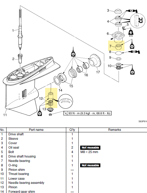

Hello everyone, I own a 2004 Yamaha F150TLRC. Recently I drained the lower unit because I had changed out the prop shaft seals. Just making sure I had no water intrusion, which I didn’t. No water but a bunch of shiny metal on the magnet. I found the upper drive shaft thrust bearing gave up. When I pulled the drive shaft all the roller bearings from just above the pinion gear fell into the bottom of the lower unit. I found info that this bearing was a caged bearing, then I found info it was a full complement bearing no cage. I even found info stating use heavy grease to hold the rollers in place so when the drive shaft is replaced they stay put. Please someone who knows clear this up.
