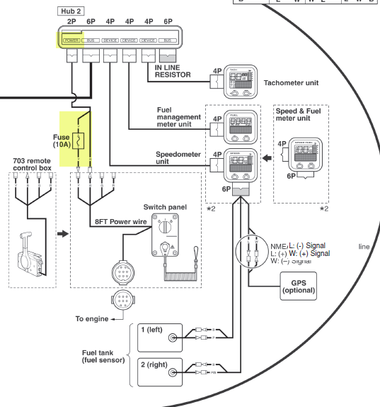

I have a Yamaha f150 (c. 2014) and the square Command Link gauges. Over the course of the winter, a red squirrel took up residence under my cowling. I discovered this when I went to check the oil levels prior to my first run of the season.
It turns out the b*gger chewed most of the small wires in the front of the cowling as well as the tilt wire. The damage appears to be confined to this area inside the cowling. The battery power was turned off all winter. I was able to splice all of the wires back together. The engine runs fine, and the tilt is good, but I have blank displays on the Command Link gauges. My dealer is swamped and hasn't been able to get me in.
As far as I have been able to determine, there is not a fuse in the feed to the gauges, but if anyone knows otherwise, please speak up. I checked the fuses on the engine and they're fine. Failing that, I am wondering if I'm missing a ground someplace or even a wire that was completely chewed off. The wires I reconnected all seemed "obvious" with colour coding. There doesn't appear to be any power to the gauges at all... no display, no backlight. They're DOA.
