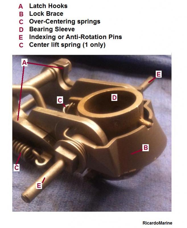

Question: Would a broke spring located on the shaft pin on the portside of the retaining pawl mechanism cause the outdrive (280) to cavitate above 2000rpm?.:confused:
Question: Would a broken spring located on the shaft pin on the portside of the retaining pawl mechanism cause the outdrive (280) to cavitate above 2000rpm?.:confused:
Are you asking about the Port side over-centering spring?
If so...... I would have to say NO!

Are you sure its cavitation and not the hub slipping? healthy props ( no bent blades) don't cavitate. Has this always done this or is it a new problem? That assembly and the pawl only comes into effect while in reverse. IS this cavitation while in FWD or REV?

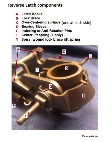

First off..... I found an error in my image and made a few corrections to it.

Stephen, I do not see how the reverse latch, or any of it's components, could cause propeller cavitation.
It is more likely that your prop hub is bad, or the prop caught something and held onto it for a while.
I am with Bob...... either take your prop in for a test/repair........., or install your spare prop and give it a try.
And as far as the spiral spring goes...... that little spring provides lift to the lock brace.
The lock brace becomes depressed (via the coupling rod) while the drive is in Reverse.
In theory, this prevents the latch hooks from releasing while reversing.
