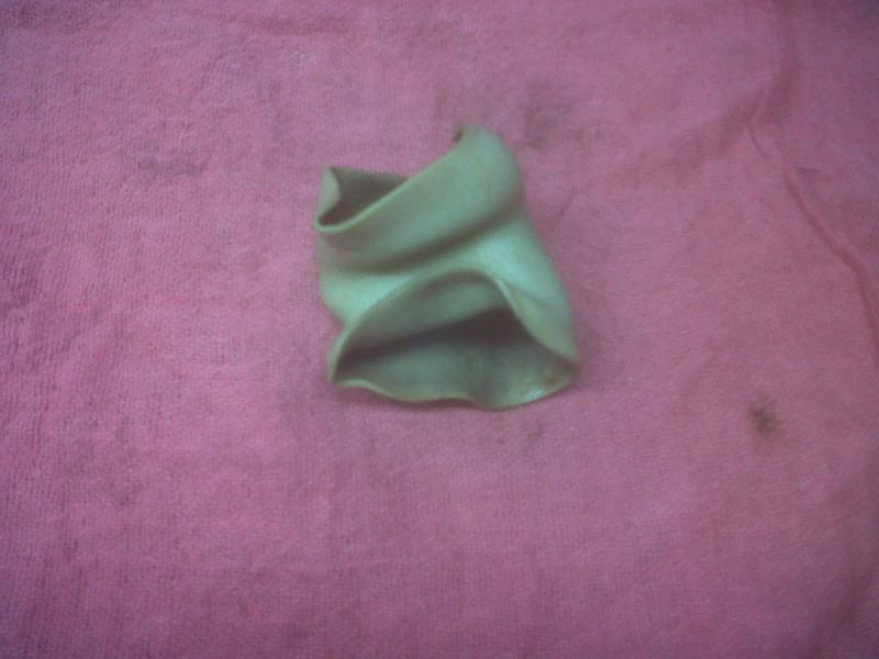

I am embarrassed to admit I have never changed the impeller in the 5 years I owned the boat and I doubt the original owner did either so that could make this a 17 year old impeller. Amazingly it was in very good condition with no vane cracking, little tip wear, still pliable & following the contour of the pump housing. My question: There is a plastic sleeve over the water tube that looked like it melted - see photos looking up into the drive shaft housing and the removed sleeve. Did the hot exhaust do this? What is the purpose of the sleeve - align the water tube into the coupling assembly during installation and it has no purpose after that?
Ayuh,..... That's all that sleeve is for,... alignment of the tube....
I'd suggest a Full water pump rebuild Kit, with a new housing...
If everything ran without water long enough to melt that tube, ALOTA things got Way To Hot....
The Shutters, just at the top of the y-pipe, are probably Smoked,....
The exhaust rubber couplers are no doubt Burnt internally, possibly even the bellows, if so equiped...

Bondo, thanks for the response. If the cause of the plastic sleeve melting was from running without water for a long time, it must have been before I owned the boat, and no problems with the outdrive surfaced during those 5 years. I always heard that dry running would wipe out the impeller within a minute but it looked surprisingly good. The pump housing shaft seal was worn out but that's about it. I replaced the water pump impeller, shaft seal and gaskets but the housing looked shiny withoiut any scoring so I didn't replace it. I inpected the 2 bellows and they looked good but I'll check them closer. The exhaust rubber couplers at the risers looked fine too. I have never had water in the outdrive oil or oil level drop so it seems to be well sealed but I will confirm with pressure / vacuum test. So, I haven't seen any other supporting evidence of running dry. Is it that uncommon for the plastic sleeve to melt due to normal exhaust heat?
There could be many reasons why that plastic tube melted and many were allready listed........If all worked well then I would not think there is anyhting to worry about. A good inspection and a definate replacement of the impellor is needed as you are in there allready!!!
Becuase it was stuck upward on the copper tube I would suggest that the last person who replaced the impeller never looked UP.......

You know, it is very plausible the original owner ran it dry causing damage, then a shop repairing the outdrive & leaving the melted sleeve there. That's maybe why the impeller looked so good.
