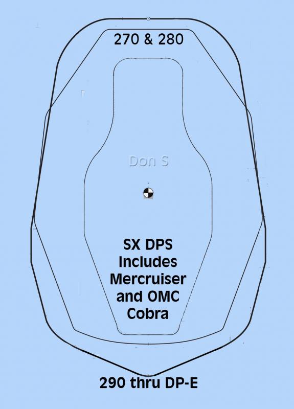

In case any one else is wondering what this thread is about, here is a drawing comparing the 3 cutouts that Volvo Penta has used over the years. Note that the smallest cutout is now standard for most makes of outdrive. I suppose that this is to accomodate repowering a boat that had another brand drive installed. My current DP-A drive uses the 290 cutout, while the DP-SM I also have that matches the 5,0 GI uses the smaller cutout. Many people felt that VP made a step back by going to a gimbal shield copied from OMC who copied it from Mercruiser.
The way to deal with this is with either an adapter plate, or by repairing the core. After the hole is glassed over, a new hole is cut.
Yes, the smallest cut-out is for the Gimbal suspension drives.
Today that would be Merc and Volvo Penta only. (OMC's last production was end of 1993)
Volvo Penta initially designed the SX and DP-S as to better gain market share. With this cut-out, the boat manufacturers could now fit either Merc or V/P stern drives.
Yep!
The original cut-out actually fits the 250, 275, and 285 as well.
