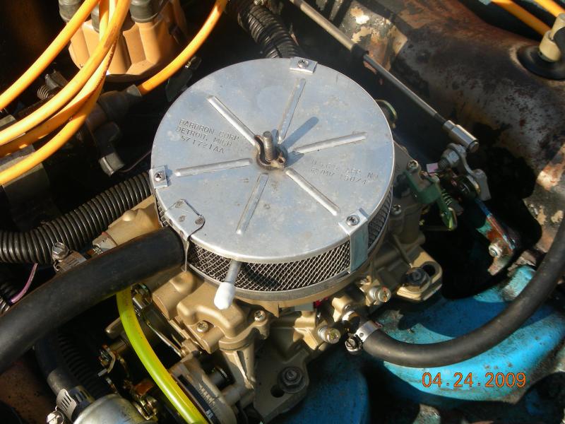

Simple Install:
The hose clamp on the fuel line in the picture is not Coast Guard approved, no clamps between the fuel pump and carb. The surveyor always checks this on my insurance survey.
I installed new Edelbrocks on my boat this last spring and they ran great all summer. No performance or fuel consumption difference but the fuel smell after shutdown is gone so my wife is happy.
The fuel inlet is on the opposit side as the original so take some extra hose and fittings with you.
Dan
