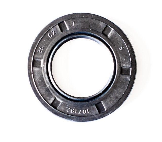

6206-2RS bearing (sealed) and a 35x62x7mm Timken or TCM single lip seal.
Both should run you about $30 tops.

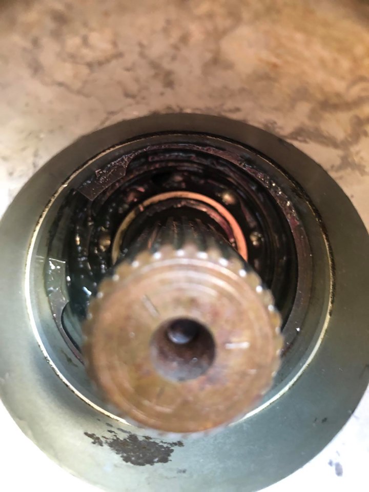

Well, Seal came off, cavity loaded with grease! Bearing is not sealed :(
See:
So does this mean I have a grease fitting? The only on I see is on top of the steering arm assy. Is that it?? Thanks, Rick.
I've also seen thread on another way to grease without a Zerk? An opening in flywheel housing? Sort of confused now. Did C drives have open bearings also? Not sure what to do next.

The C drives used a single bearing PDS.
Since there is no grease port, these are sealed bearings.
If an open bearing is used, it will lose it’s grease and will fail prematurely.

Yes, that is one of the C drives.
Never pull an entire drive....... pull transmission only, then the rest if need be!
Since it looks like a DP, you will use the heavy gear oil.
Yep its a DP. So is is possible that early C drives have open PDS bearing set up vs. Sealed? Not sure how to proceed with this bearing situation. Can a sealed bearing be installed in place of the open bearing?
If you are the original owner, and if you have NOT changed out the flywheel cover, it should be a single bearing PDS........ i.e., sealed bearing.
If the flywheel cover is red, then it will be a double bearing PDS..... i.e., two open bearings..... and the F/C will have the grease port at the 12:00 O'clock position.

Remove the AFT seal.
Reach in with a long needle nose pliers (tips altered to work with the snap ring eyelets) and remove the two large snap rings.
Now see if the PDS can be pulled out.
Single bearing PDS (one sealed bearing) can be removed without engine removal.
Double bearing PDS (two open bearings) cannot be removed without pulling the engine.
Yes!
The AFT bearing (in a sealed version) will be a 6206-2RS.
The AFT bearing (in an open version) will be a 6206 and with a 6007 FWD bearing.
However, if the F/C has the grease port, you would want to installed open bearings (two of them) so that they can receive grease in the future.

Found a new Timken seal locally 35x62 x 7. Thank you

Both seals will be a 35 X 62 X 7mm in a Timken or TCM brand.

Good view of the top of the cover. Clearly, No grease zerks.
looked over the transmissions for the 432B engine and there are no grease zerks
Is it possible that whoever set this up 15 years ago used an open vs a sealed bearing?
Will I hurt anything trying to pull it, or can I ? If double bearing.
Sorry for the confusion....!!!!
I think someone might had substituted ad open PDS bearing instead of a sealed on and manually packed it with grease. There is no way to externally grease it otherwise. My son says "repack it and put it back together".
In order to re-pack it, you must remove it, clean it, inspect it, etc!

I have a new AFT seal in hand.
You probably have the AFT most universal drive shaft female yoke seal in hand.
I.E., the 35 X 62 X 7mm seal.

I keep shaking my head wondering why I see the open bearing installed and can not find any way to add grease externally.
This was a mistake by the last person in there!
If it truly is a double bearing set up with no external grease points I can't pull out AFT and would need to remove engine or slide ahead.
If there is NO grease fitting at the 12:00 O'clock position, it's very doubtful that it is a double bearing PDS .
As I suggested earlier, remove the 35x62x7mm seal, remove the two large snap rings, and try to pull the PDS out.

Well, well, well. Lookie what I found! Add it to the wall of shame?? :mad: Open bearing installed with grease. Came right out. New sealed bearing on it's way.!!!!!!!

Also put some grease on the lip of the 35x62x7mm seal.
With YOUR set up (non-serviceable), the open side of the 35x62x7mm seal does not necessarily need to be facing AFT.
However, that is how the OEM wants them to be.
