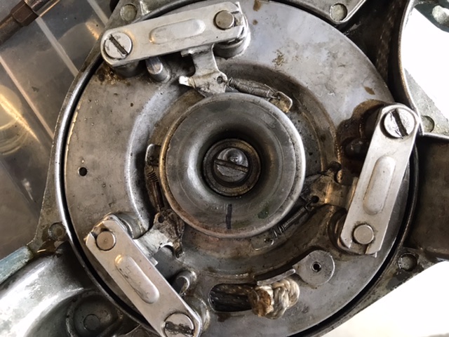

Replaced the recoil spring in my starter today
333Fitter
It's on my ' 55 Evinrude however the dogs ? Wont spin out to grab flywheel Y ?

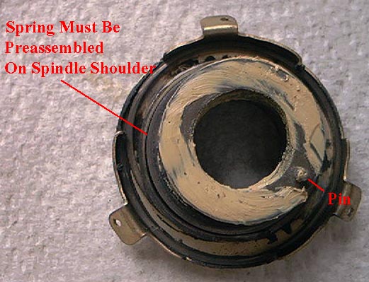

Simple. We see it all the time. Equalizer spring must be pre-installed up on ledge of hub.
