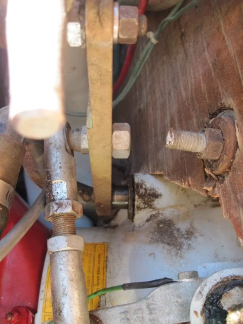

I do have a question about the steering linkage though. Is there something that should hold this pivot pin into the transom shield? It never comes out any farther but just to be safe I've fabbed a spring like arm to keep it in place.
Yes, it is missing a keeper plate.
This plate is secured with the two studs that secure the chrome water tube to the transom shield.
The plate prevents the steering linkage bell crank arm from moving forward and out... although it will never come completely out.
