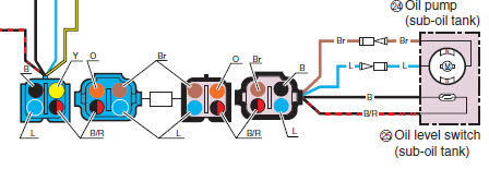

Hey so I bought a used 2 stroke Yamaha 250, everything was on a pallet when I got it. I cant find where the remote oil tank clips in in the motor, am I missing somthing obvious here? It’s a build make connector on the remote tank. It’s a 2001 Yamaha 250 salt water series 76 degree
It is a dark blue four pin nylon connector. Four wires connected to it.
No idea what a build make connector means.
The connector is for the automatic oil transfer system. No transfer, the alarm will sound if and when the engine mounted main oil tank runs low.
The four wires are for the sensor in the oil tank and for the oil pump itself.
The connector is usually up front with two ivory coloured four pin connectors and one black round ten pin connector.

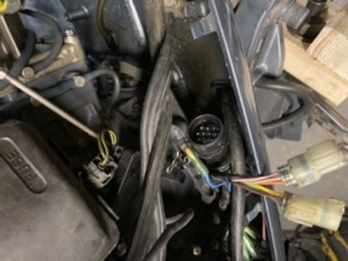

hey so I found the oil tank connection, was tied up underneath the block. I forgot to ask what the blue cable with the bullet connection is for, have you seen this?
Blue is the wire colour for a solenoid activated choke. Which your model does not have. Thus the wire is not used. Redundant.
