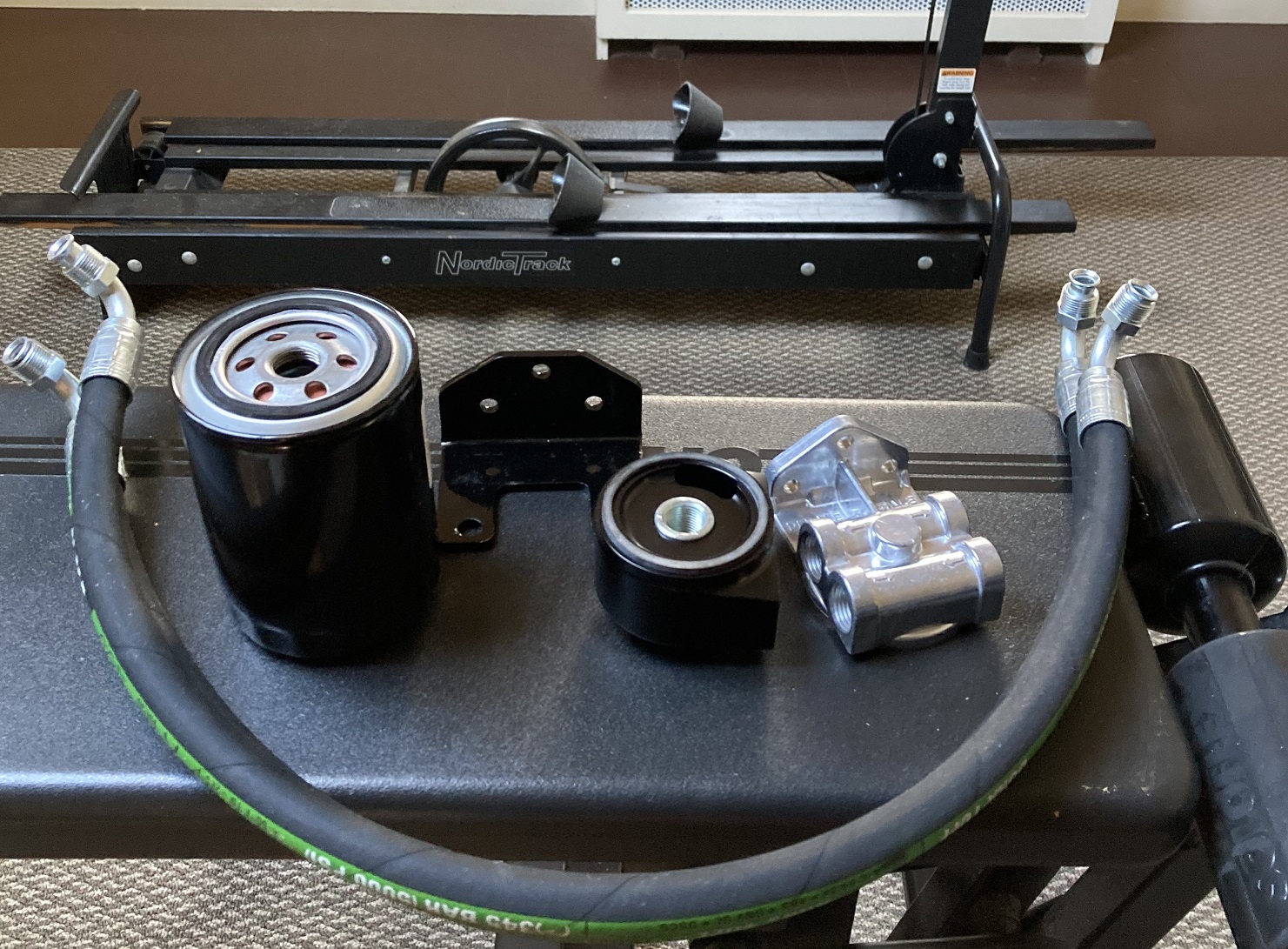

Here's the one Michigan Motorz sold me for my 4.3, it's the same one they use on their turn key engines, set up so the bracket bolts to the OMC/Volvo style exhaust I have on it. Like I said, I didn't install it due to concerns about the bypass valve in the block which on a 4.3 is very difficult to change with the engine in the boat. What I thought of doing, which might be one way to tell if the oil bypasses the filter, is this.

I think the set up that MM sold me is a good one, it looks well made all around.
Honestly the remote filter system is something that has to be top quality, a failure will destroy an engine in minutes. So paying more for the best system you can get is the only way I'd do it.

Just for information that mount in the kit that I bought from MM, was made by Canton Racing, you can find it on their website.
