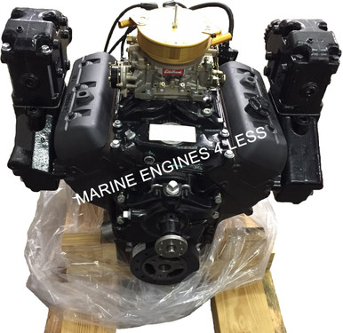

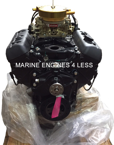

here is another place - 4.3 reman partial engine
and with exhaust
