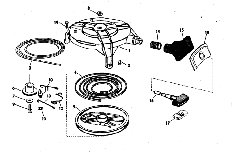

That's what I would think as well. Looking at the parts diagram attached, #2 on the digram is part #0304500. A Google image search comes up with the other picture attached.

304500 is called a guide pin !----Found on the back of the housing and acts as a bearing for the sheave.------The anchor pin for the spring is steel.-----Knock that out.-----Find a pin at your favourite hardware store !
