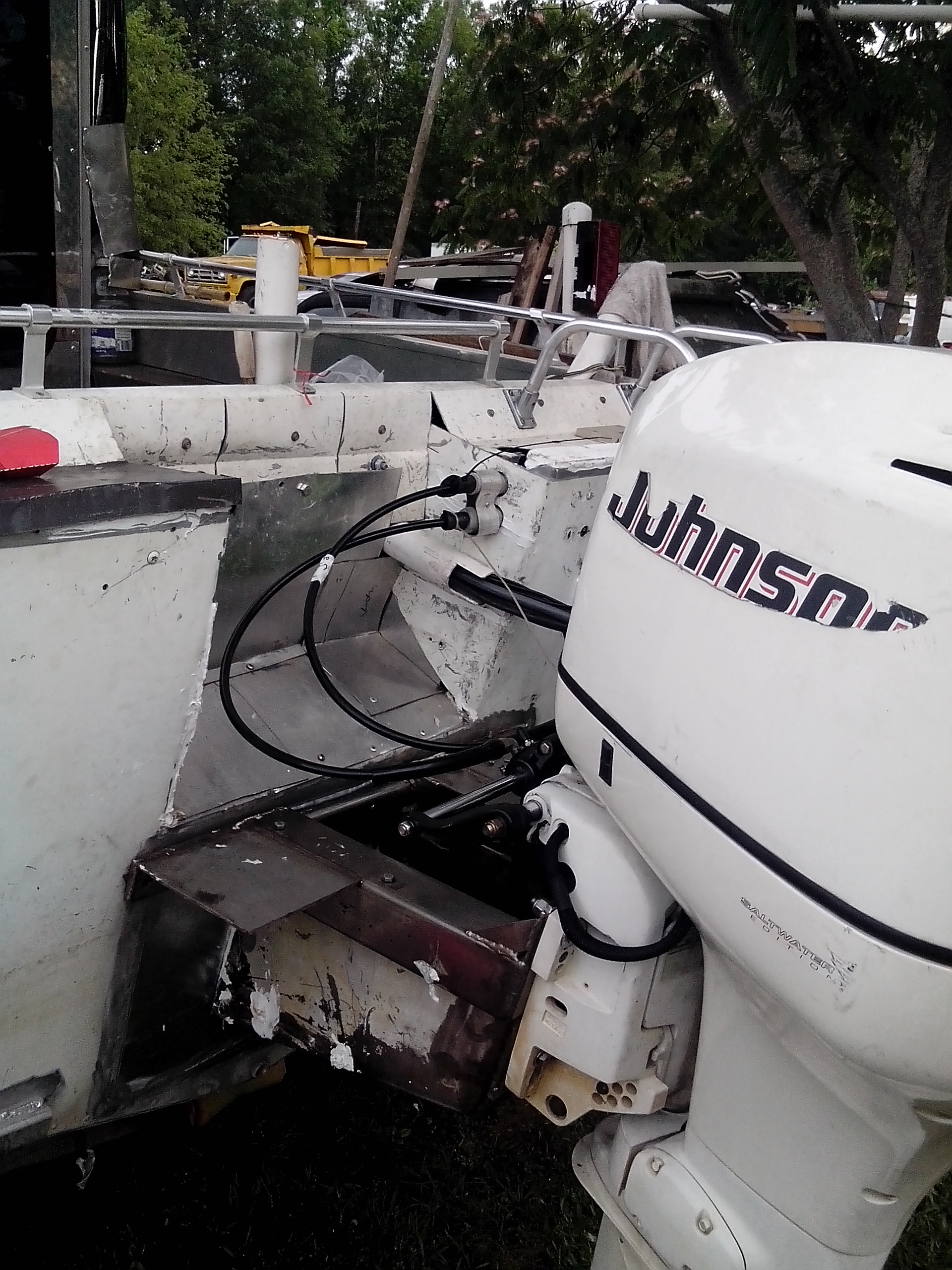

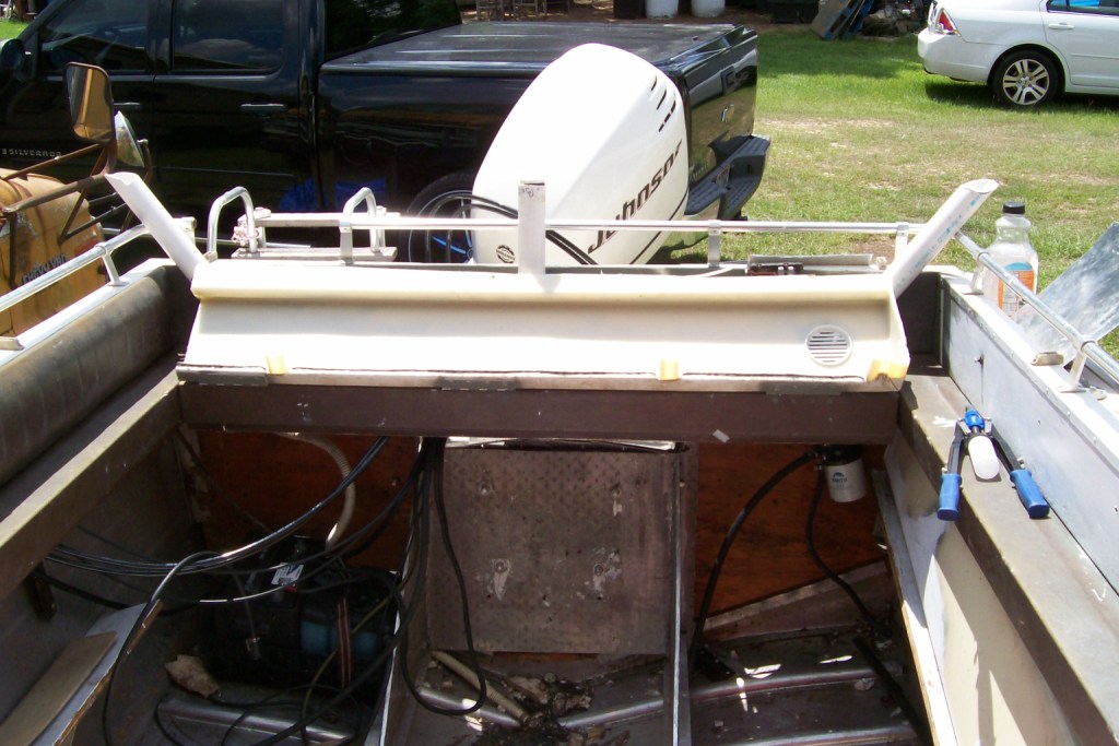

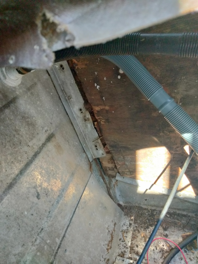

Ten years ago I seriously messed up the transom 77 Chieftain 22’
Where I messed up a couple times.My orginale plywood transom appeared to be 2” thick
It mite have been swollen. I believe Starcraft didn’t use ¾” plywood I think it was 3 layers of 5/8” which is 1 7/8.
The flange this plywood sits in was a tad smaller than 2 “ BTW orginal transom was in pretty good shape it was painted on exposed inside.
    • I actuely had to grind down the thickness around the perimeter of wood to get it to slide into the flanges.this grinded down around the perimeter never got sealed now is flaking off.

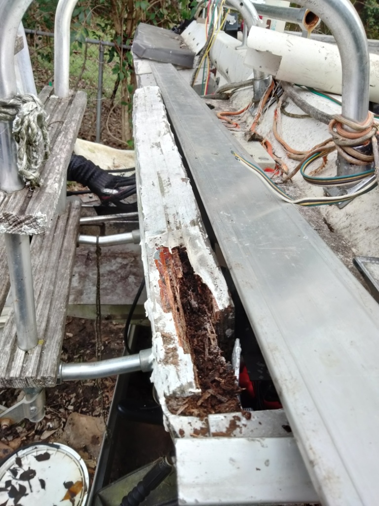

2.The lumber seller didn’t have ½” marine grade plywood. Sold me ½ regular I thought well I’m sealing it anyway wronge.
3.glued all 3 plywoods together ¾” x 2 an the ½”in middle w/ construction glue
, lumber place say it was waterproof wronge. look close you can see the 1/2" middle piece the marine is in better shape but is delaminating
    • sealed w/ cheap urethane from home depot wronge.

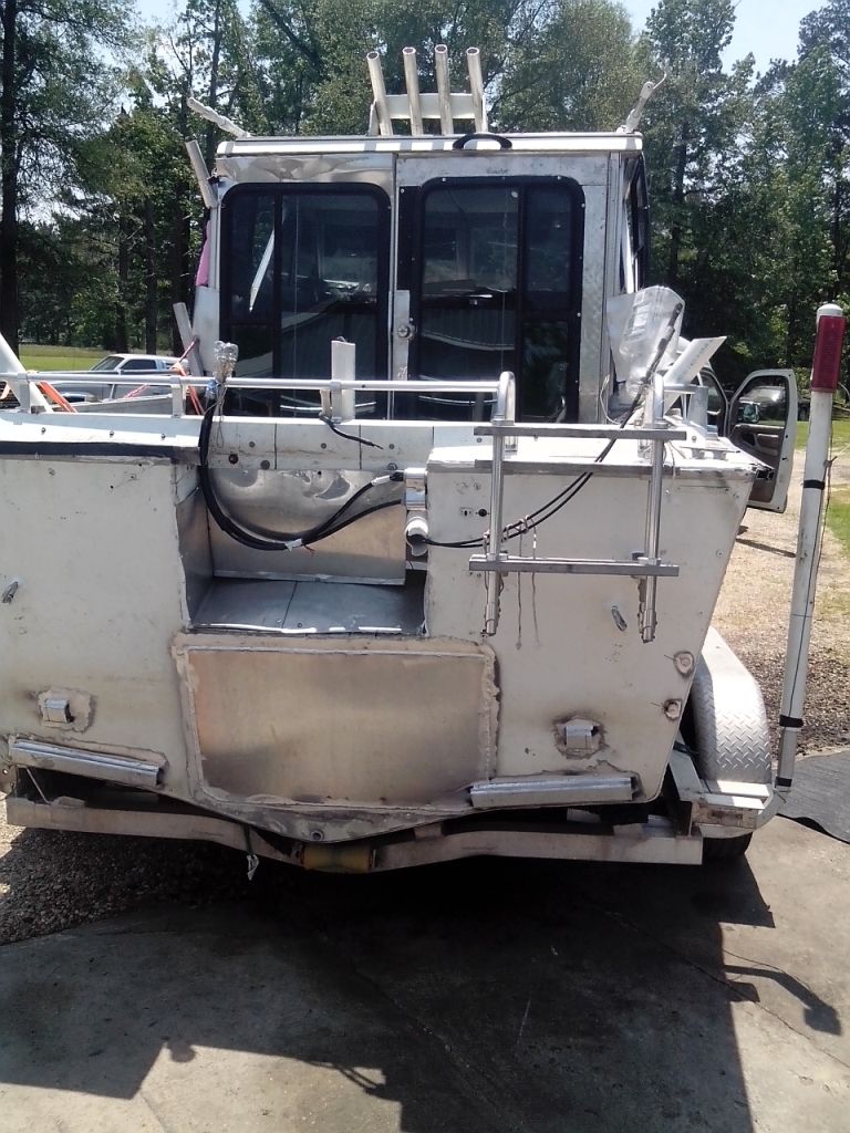

    • I had to cut the transom skin off the vessel to remove the transom. left the star side half exposed used 5200 on the top of this star side wronge.
I sealed top of port side w/ 5200 an fabbed a new aluminum transome skin this port side isn’t rotton.
The small section ontop of star side is where the ½”ply got rot. See the allen key stuck down about 4 “ so it’s not totally rotton. The exposed ¾” ply is in pretty good shape however there are spots where I can stick a screwdriver into maybe a few layers of ply
See when I left the top transom skin off this plywood was exposed to rain.
I thought so what is been covered in urathan an top was coated w/ 5200 wronge.
Again port side is unaffected by any rot. Where the outboard engine mount bolts are seam dry.

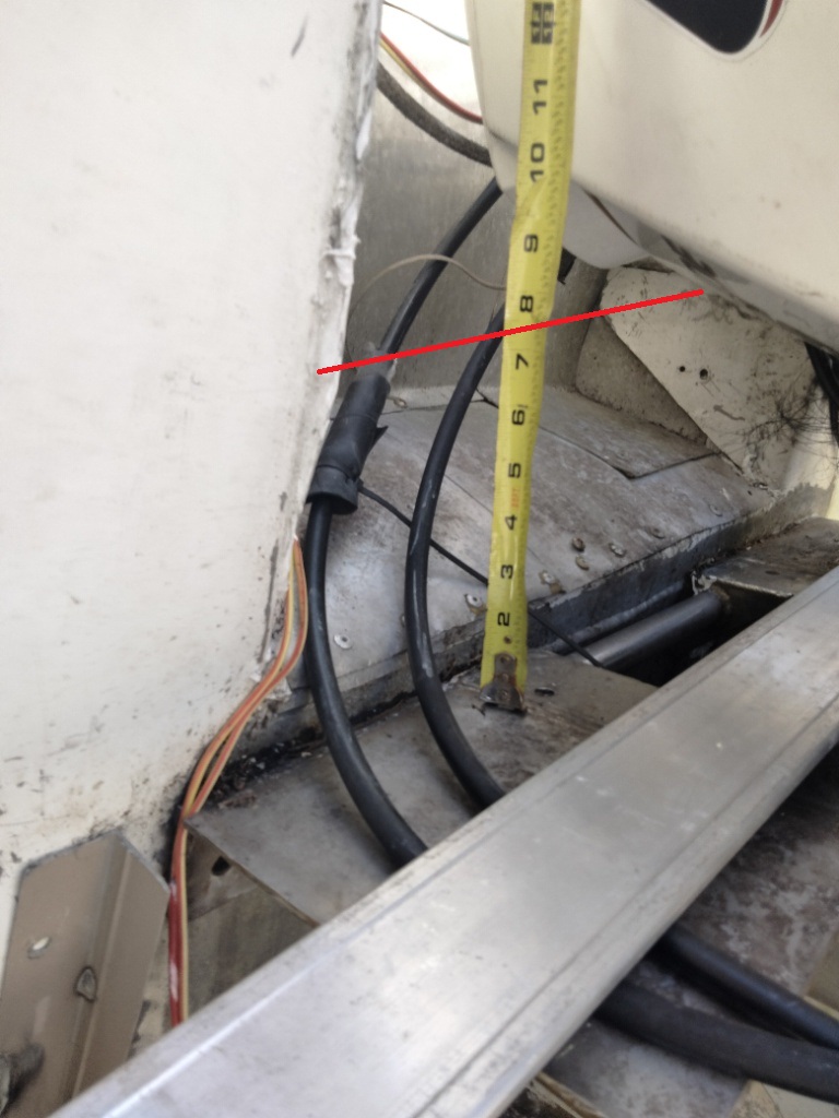

I need to redo the transom before next cruise. again w/ ¾” x2 marine plywood an I have a aluminum scafold

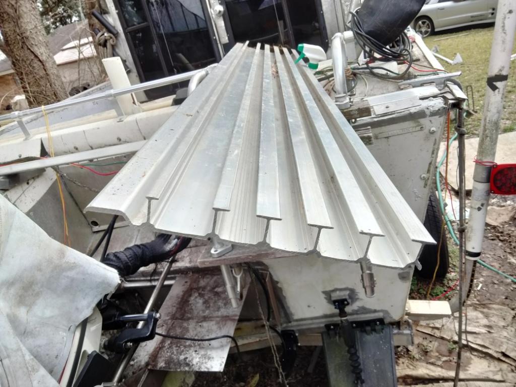

to reinforce the 1 1/2" plywood plus an overkill kneebrace.

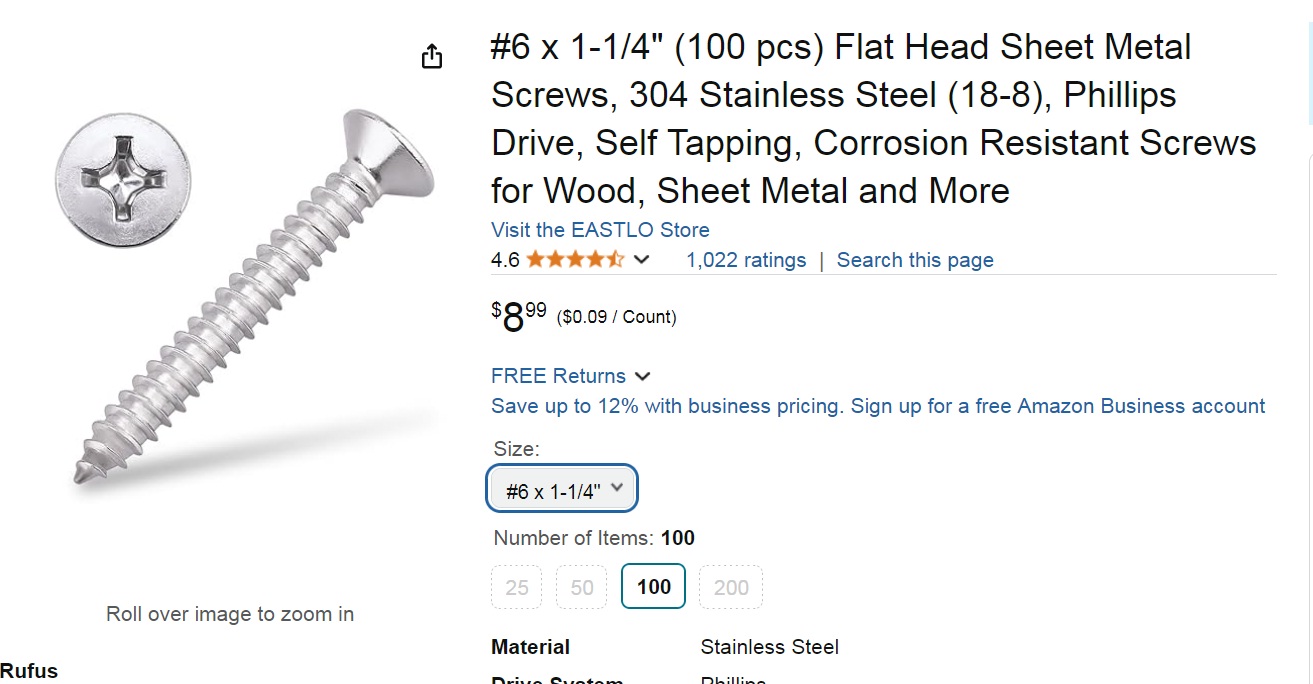

edit: Starcraft used stainless steel though hull screws to hold the transom wood into the flanges.

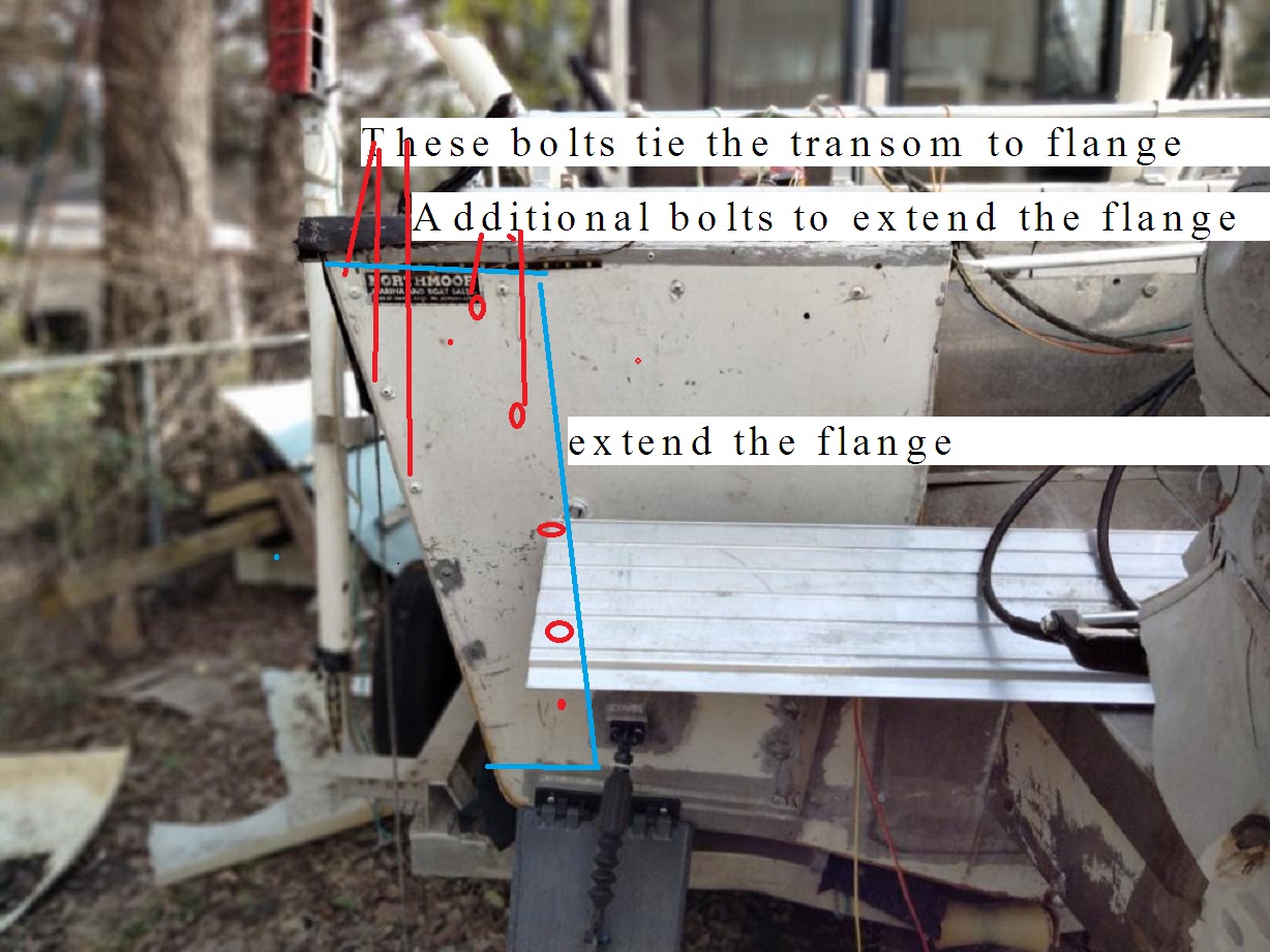

more on this subject.since the current transom is deterating all around the perimeter I was actuely
considering extending the side flanges where the transom sits in.
I was also considering using the scolfold material to fab a complete aluminum transom which mite be a tad more involved bc of the sides being much higher than the cut out splashwell.
either plywood , coosa still haven't ruled out liquid transom it will be much higher by 7.5" my new ETEC engine fully tilts.
considering probally the easiest method which would allow me to leave the engine attached to transom.
remove the current transom wood w/ engine pod still attached. slap a inside transom skin on an use liquid transom. what do you Guys think
Here is what I think as a fellow StarCraft owner. Won't the bolts running through the transom need to be removed to get the old wood out anyhow? Also, not being super familiar with the pour in stuff I am curious if it can be poured over through bolts, or if they recommend drilling through bolt holes after it has hardened?
The idea of anything other than wood for the transom has always been something I have been interested in; but for me however I chose not to do that simply because of cost.
As a fellow Starcraft owner here is my concern with leaving the engine attached for the procedure. As mentioned above your current transom construction only has an aluminum sheet and the transom wood. Once the transom wood is removed there is nothing to support the aluminum and it could potentially bow outward with the weight of the engine pulling it that way. That said if all of the bracing you have done distributes 100% of the load of the outdrive down to the stringers and you are confident that there will be no load on the transom once the wood has been removed then you might be fine. I can tell you that with no transom wood my aluminum transom skin had good amount of deflection. It basically flopped back and forth if I poked it with one finger. I know that if too much force is applied to the transom skin while there is nothing to support it on the other side it can shear/ fracture. The transom wood on my boat had rotted away at the bottom below the outdrive and the previous owner hadn't noticed it. As a result there were a pair of 4" fractures near the bottom of the outdrive hole that I had to weld up.
Out of curiosity why are you considering extending the flange on the transom?
By the way with regards to fasteners for your transom wood:
Basically what types of metals are compatible for your situation will come down to Anodic Index. The difference in anodic index, and environmental consideration determines what metals are similar enough for your application. Starcraft uses 5000 series aluminum; 5052 to be exact. The anodic index for that should be roughly 0.90. For harsh conditions (marine environment is considered a harsh condition) there should be no more than a 0.15 difference in Anodic Index. So it will depend on the Anodic Index of the steel you intend to use. Low alloy steels will be safe as those will be around 0.85. Galvanized steel and chromium steel would be well out of compatibility range.
I hope this helps.

the purpose of extending the side an even bottom transom flange is bc the perimeter of the transoms wood has deterarated all along where I reduced the thickness so the wood would slide in as explain above also the orginal flange is designed for a inboard which doesn't have as much stress as the outboard puts on it exspecially w/ relocating engine back 20" adds a cantilever effect.

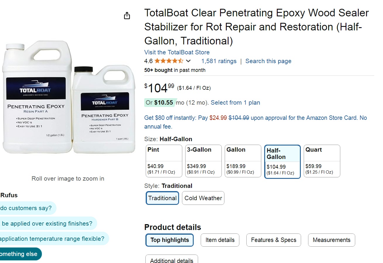

I've been informed from total boat to seal it w/ this

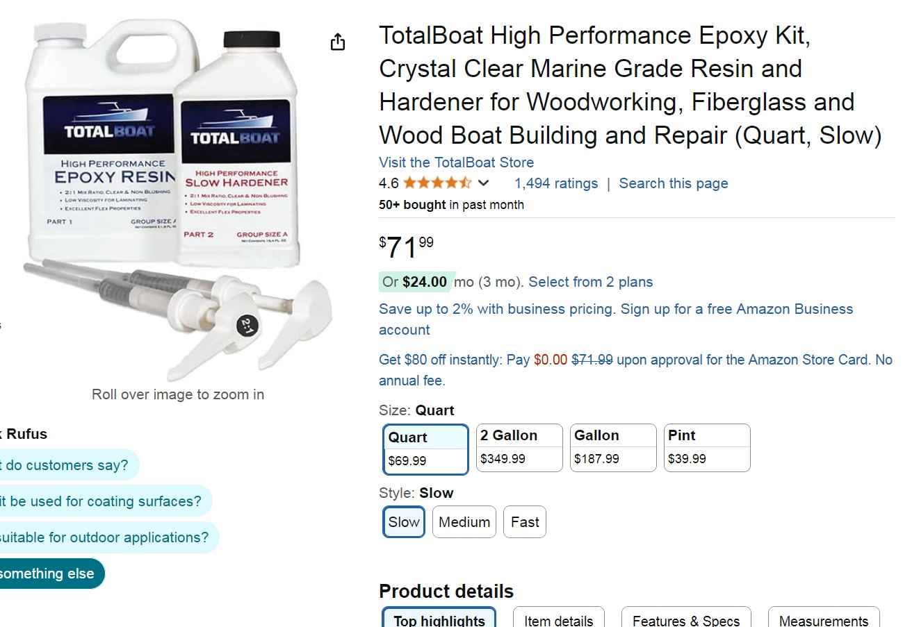

bond the two pieces of plywood together w/ this
add silica to the extra strong epoxy for strength. this
unknown to me the complete procedure I'm assumming step 1. would be to bond the two plys together.
unknown how much silica to add. I've watched a few videos at amazon the extra stronge epoxy seams very good an should probaly cover the whole board.

heres all the Rot areas,would prefer to repair an procrastinate replacement
1. all of perimeter couple inches inward except for under engine pod.
maybe I can drill small holes all around the perimitor an inject the penetrating epoxy? then extend the flange on both sides?
the original flange is just rivitoed to freeboard the bolted w/ 1/4" x2.25" stainless bolts I could add about 8" of flange then use 1/4" X3" stainless bolts.
This splashwell rot which is mainly the ½” of regular plywood outward.
I’m considering drilling w/ a 3/8”X 18” wood bite outward to remove as much rot as I can reach.
Then pour liquid transom Arjay 6011-Ceramic Pourable Compound Transom Putty-Cruise.
Mite be a good idea to even drill out the not rotted ½” regular wood, would probably make the pour easier. Kindof like pouring inside the transom.
inbetween the whats still good marine plywood. Then seal the wood w/ epoxy an seal the splashweel better I was actuely planning to have the splashwell welded but was concerned bc I used very thin 1/16” aluminum.orginal aluminum is 1/8”.

I plan to leave the screws in the two sheets of ¾” plywood then epoxy over wood an screws.
Is this the proper screw? thanks
