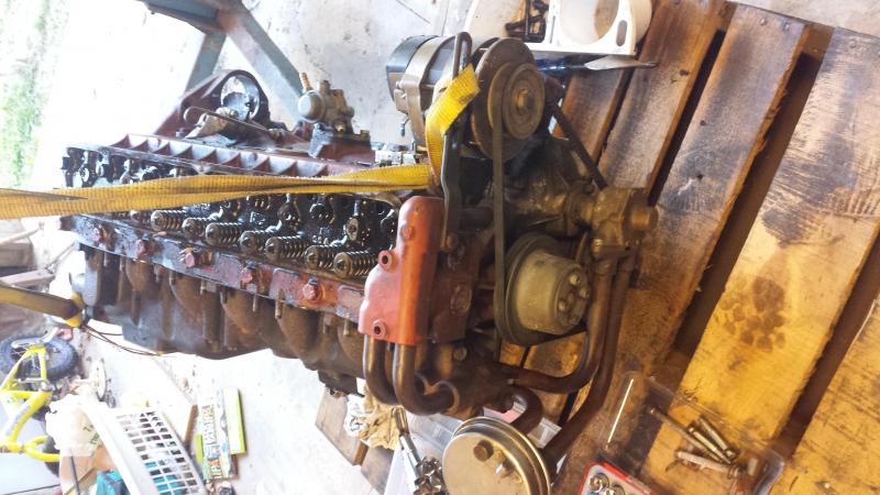

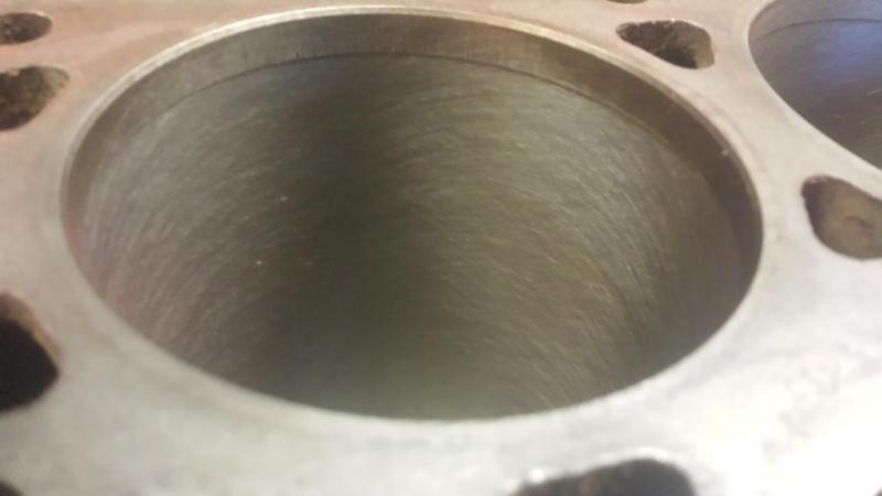

hi guys. i went ahead and started a new thread. Im attempting to rebuild my aging aq170. many of you helped a ton already, but in the interest of documentation for future gluttons for punishment, i wanted to correctly title the new thread.
here is where i am now. I have the engine out of the boat. i took it out at the bell housing. I have since heard that it is not an ideal way to remove it and i should have just left it attached and pulled the whole housing out too (im not sure how to do that, but its ok, cus its already out now). I have it on an engine stand in my garage. tomorrow i will disassemble it and have more questions. one thing i noticed and i mentioned it to my dad. there is a little hole in the housing for the water pump or something connected to the pump on the front of the motor. it totally looks like it is supposed to be there. i was telling my dad that water would come out of that hole when the motor ran, he said they put those holes in car motors to tell you seals were bad. Does this mean that i have a bad seal in my water system? thanks guys! -kevin in michigan

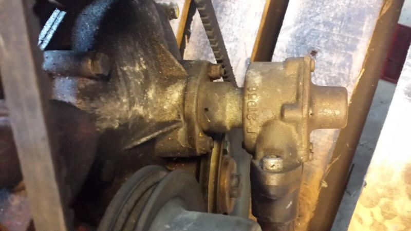

Hi Kevin,
Your Dad was right. If the water pump seals go bad it'll leak water out that hole. That said, if the motor hasn't overheated on you, it's not a problem at this point.
When you get your motor all apart, IF you decide to stay with this particular motor, and if you decide not to get a short block or another motor with low hours-- then find a good machine shop. Take your block, head, crank, pistons, rods, cam, etc.. and have it all done right. Then you'll know if it needs to be bored out, the crank and cam machined, the head done right, etc., etc.. If you just take it apart, do a quick hone job with new rings and bearings--you could end up a motor that won't last long at all. There are books written on how to rebuild motors--it's a big subject. Talk to a trusted auto machinist and maybe a good mechanic who will help you put it all together--the right way.
Hope this helps...
I forgot something. Other than the engine being old, why are your doing the rebuild? I was just thinking, it might be ugly on the outside, but if the compression is good in all cylinders, and if the oil pressure was good--and it wasn't making strange noises from inside-- then you might not need a rebuild. If you've done regular maint. then you might be able to get a few more years out of it? Maybe, perhaps? Just sayin'.
Perhaps you could get by with machining the head and a valve job, some new gaskets--exterior parts like a new exhaust manifold, pumps, things like that.
It might help the guys here with many years of experience to give you better guidance if you gave them a little history on the motor. Like how many hours, what it was doing to cause you to pull the motor, etc..
Just wanted to add this to the mix. Doing a complete and proper rebuild is not cheap.

here is a little update: its all ripped apart. i got all the pistons out and rods, crank, pretty much everything. its in the back of the truck and going to take the block,crank,pistons, rods and head to the machine shop tomorrow, along with the manual and he's going to tell me how bad it is. one thing to note, the bearings,and both the tops and bottoms of the rods were all stamped so i didnt need to number them. does that mean its been rebuilt already? the cylinders looked smooth and i could still see the horizontal machining marks on all of the pistons. they all had all of their rings intact. another thing worth noting, there was a dark ring about 1/2" of an inch from the top of the cylinders all the way to the top. it just looked like buildup. not sure if thats a sign of something. maybe ill get lucky and it wont be too bad. as always, thanks again for all of you guys help.
new update: i got the news from the machine shop. the head had 2 small cracks in it. he said it would probably be ok because of the location of them and the fact that its a low pressure system. i told him i had an AQ170B (mine is an AQ170C)in my garage that came with the boat. I dont know what the differences are between the 2, but i took the head off and took it to him. he said it appeared to be the same and it had no cracks. he is remanufacturing the head and honing the block ( he said the block was good and no need to bore open). he checked the crank and is just polishing it. I should get it all back tomorrow. I ordered a gasket set for $355 and rings for $55. I have no idea where im going to get bearings. They dont even need to be oversized. He said most of mine were in good shape and all of them would work in a pinch but it would be nice to get new ones since i have it all ripped apart. If i cant find them soon and all the stuff comes in, i guess i will just put it back together with what i have. -kevin still stuck on land, in michigan.

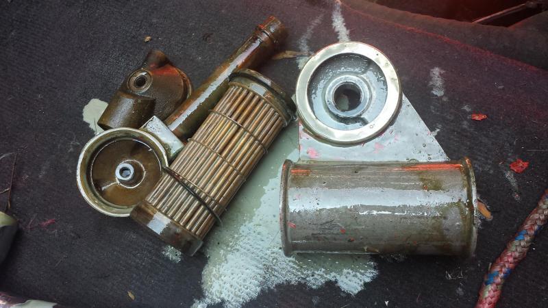

Hi guys. well after running it in the tub a few times at variable speeds, i finally got a chance to take it out on the water. it seemed to run good. I got up on plane and things were looking good. after a bit, i stopped and looked things over. every thing seemed fine. i set up to troll and got going. I checked things again and discovered my oil looked milky :( i was paying close attention to my oil pressure and my temps and both were very well all a long. I shut it down and used the kicker motor to get me in. I checked the dip stick after things settled down and it was only a little bit over the max line. I had filled it to just under the max line with oil, so not a lot of water was getting in. The engine still runs great. i am hoping its a seal or something like that. what do you think? what would be the next logical step to figuring out where this water is coming from. thanks again for all ur help! -kevin in michigan
hmm the oil cooler. i didnt think about that. thats that canister on the side of the engine with all the holes in it right? So i just take it off and take it up to a radiator shop and they would know what to do? sounds a lot better than what i had planned... head gasket, or that gasket behind the the water pump on the front of the engine. Thanks kimcrwbr1 and happy labor day!
yeah i took it apart. stupid me didnt look it up in the manual first. man it would be great if thats all it is! ill go take it off right now. thanks! i was more than a little bummed yesterday. on a bright side, we got 2 real nice steelhead before i discovered the milky oil.
well i got it apart. i didnt see anything that i would think would be out of the ordinary. regular water came out of the large copper tubes on either end of it. the outside center section was milky but the tube parts wasnt. maybe they wouldnt be because the water pressure is higher than the oil pressure? the filter was milky as was all of the areas where the oil would have been. it appeared that it had all of its o rings and was assembled right. I took the canister off the one that i had in the garage and put it on but i really have no way of telling if that fixes it unless i take the old canister to a radiator shop. i guess ill hunt one up. i checked the dip stick and its only slightly above max but still milky so i am holding off on draining it. It really looks like there wasnt that much water in it. here are some pics. thanks again for your help -kevin

well i drained the oil after putting on the other cooler. then added some more. ran it for a few minutes then drained it. looked a little better on the dipstick. then added some more. this time it actually looked alot better, pretty much normal. i ran it for 10 minutes in the tub at varying rpms. still looks good. something tells me there is more to this than what is in front of me. one thing to note. the drain plug was loose and the other day before i took it out, i attempted to wash out the engine compartment out. i left the hose on and pretty much flooded it. it seems a stretch to think that water could get inside through the drain plug but oil would not leak out?
found it guys! it was the water pump. the 2 little seals and the o-ring on the shaft that connects it to the to the engine were bad. Got it all back together and ran it at 3500 rpms for a half hr and not a drop of water in the oil! thanks again for all your help
